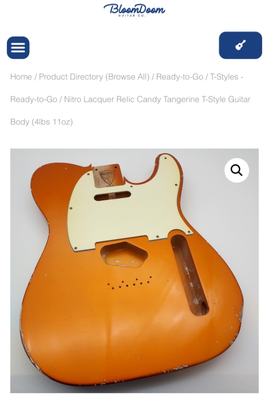

Here is the body I picked up from BloomDoom Guitars:
It’s Alder and Nitro finished.

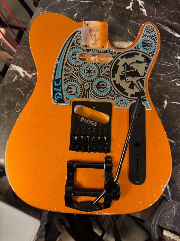

It’ll be a few months before I have the neck and can assemble. I pretty much have everything else here or on the way. I went with Radioshop Pickups out of Wales for the electronics, they have a sweet a blend send up for a Tele and the guys are really cool (I am of Welsh descent too on my Dad’s side).
My Buddy Alper (Alperious Custom Pickguards) nailed what I wanted for the pickguard. My Dad’s initials were DLC and do are mine and my son’s so a little homage to Dad. I figured Luke vs Darth to represent father and son battles was kind of fitting too. Anyways here is a pic:

Re: Partscaster (Tele) Project
Post by wdinc01 »
That's an amazing pickguard! I've seen a few of his pickguards pop up on Punk Rock Bass Player facebook group

Deltaphoenix
Posts: 4831
Location: Gainesville, Fl
Post by Deltaphoenix »
Thanks!!!
Alper is a great guy, we collaborated on getting my vision into a workable design. I totally recommend him if you are looking to personalize your guitar (or just make it look cooler).

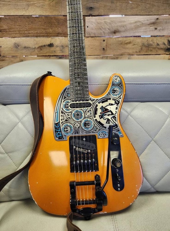

My intergalactic swamp rocker is complete and it is fuvking dope!
Deltaphoenix
Posts: 4831

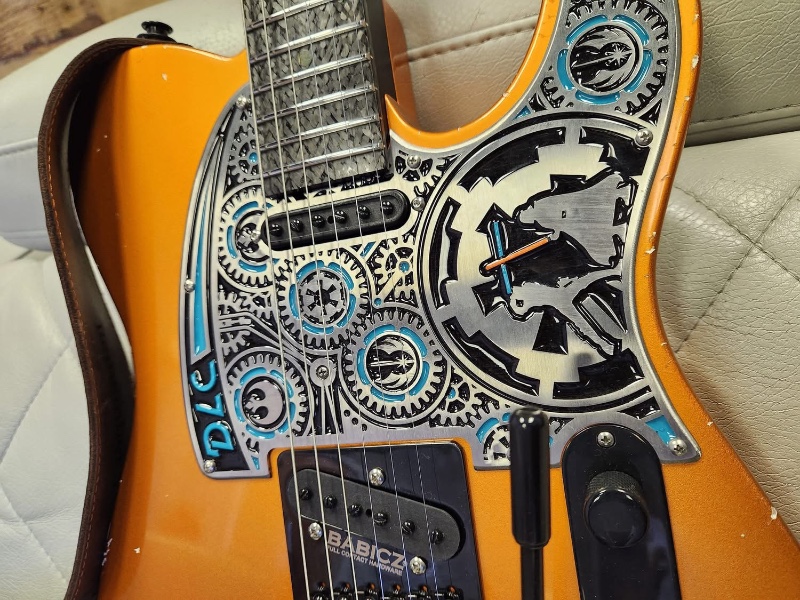

So, I am loving this guitar! It came together almost exactly as I hoped!
The Aluminati neck is fantastic! The matte feel in the back of the neck feels so nice. The action is super low, the shape of the neck is very comfortable.
The electronics rock! Having the blend really opens up the tone possibilities. The Porter pickups cover nice cleans, have a little bit of twang if I want to go there but they love gain. The guitar isn’t a chug lord but it loves to rock.
The Goeldo vibrato is great but I may tweak the Babicz bridge more or replace it - I think the added notches may need to be a little larger. With the trem, I couldn’t use the holes the string passes through so I had to cutout some metal for the strings to get to the saddles. I will wait a few weeks and think about how I want to address this one tweak.
