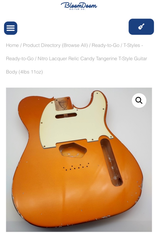

Here is the body I picked up from BloomDoom Guitars: It’s Alder and Nitro finished.

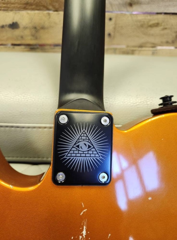

On Thursday, I bought a black neck plate with an Illuminati symbol (eye in pyramid). I have some slightly conspiracy theory/related tattoos.
