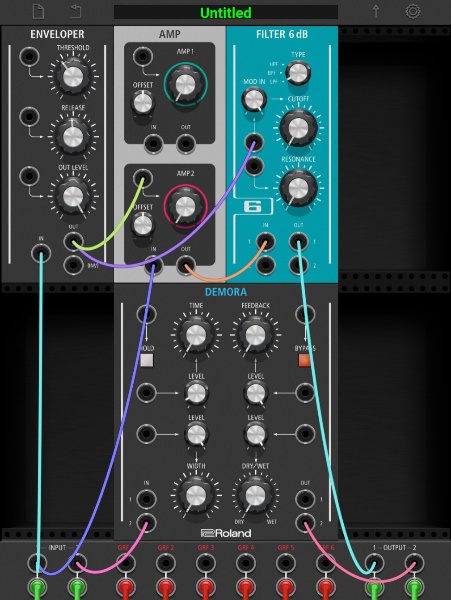

lordgalvar
Posts: 6165
Re: Low pass gate in a pedal?
Post by lordgalvar »
Might be something to try? I would, but I don't have the dongle to to fandangle it into the Roland widget. Headphone adapters :grumpy:

Yaz--definitely worth a go, virtual or no :love:
