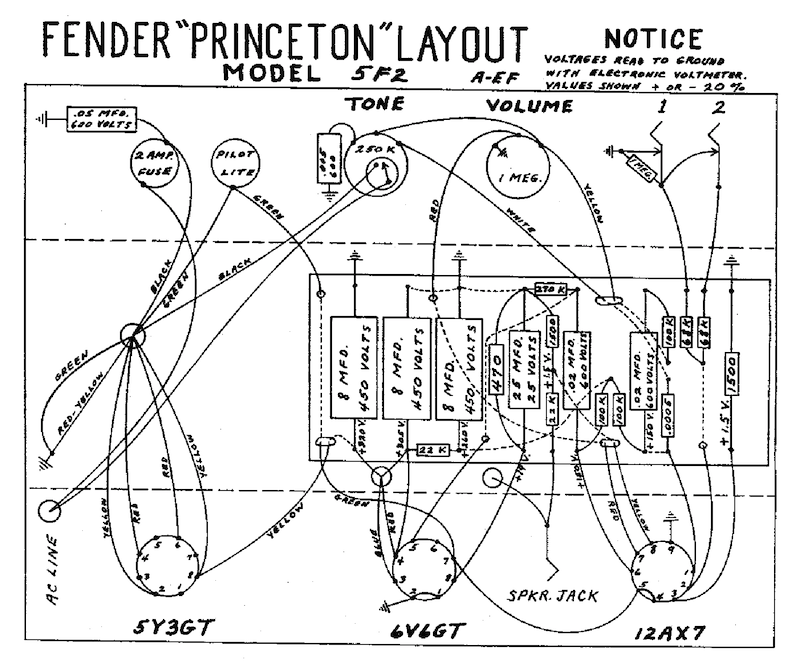

Hello all, not really sure if this is the right area to post this, but need advice from anyone with amp building experience. I'm trying to understand how tube amps work so I can potentially mod a fender of mine, but the handbook I'm reading keeps referring to "power rails", which are confusing me because:
a) I conceptually really don't understand what they do (but get the gist that they transfer DC voltage back to power the tube
b) I don't understand what object in the Fender Princeton schematic the handbook provides is supposed to represent the "power rail(s)". I've included the schematic below. Apparently, the plate (pin 1) of the first triode of the preamp tube is supposed to run the signal through the 100k resistor, said resistor being connected to the "power rail" at some point. The problem is that I have no idea what the schematic is using to represent this "power rail" that the 100k resistor is wired to, nor do I really understand what those "rails" are connected to that is powering them (the transformer?).
Any help from anyone experienced with this kind of stuff will be greatly appreciated. I'm decent when it comes to understanding a system conceptually, but if I can't visualize a component of the system then there's no hope for fully understanding the whole.

Schematics are better for understanding functions; wiring diagrams are better for understanding how to assemble.
Try this: http://vintagefenderamprepair.com/wp-co ... ematic.pdf
What book are you reading? I don't mess with solid state stuff, but power transistors are generally powered by both a positive and negative voltage (+50V and -50V or whatever) for a pair of NPN and PNP.
With tube amps, there's really only B+ (high voltage) and ground. There are heaters as well, but there's not much to talk about there.
In the schematic I linked, high voltage AC passes through the rectifier tube (which has its own heater winding since it needs 5V) which converts it to pulses of high voltage DC that charge the first rectifier cap. The filter choke (and second filter cap) smooth these pulses further so they look more like pure DC, which feeds the power tube's plate (through the output transformer), the power tube's screen, and (through the 22k resistor) the two preamp stages. Current passes through the tubes to ground, which is the high voltage center tap, completing the circuit(s).
