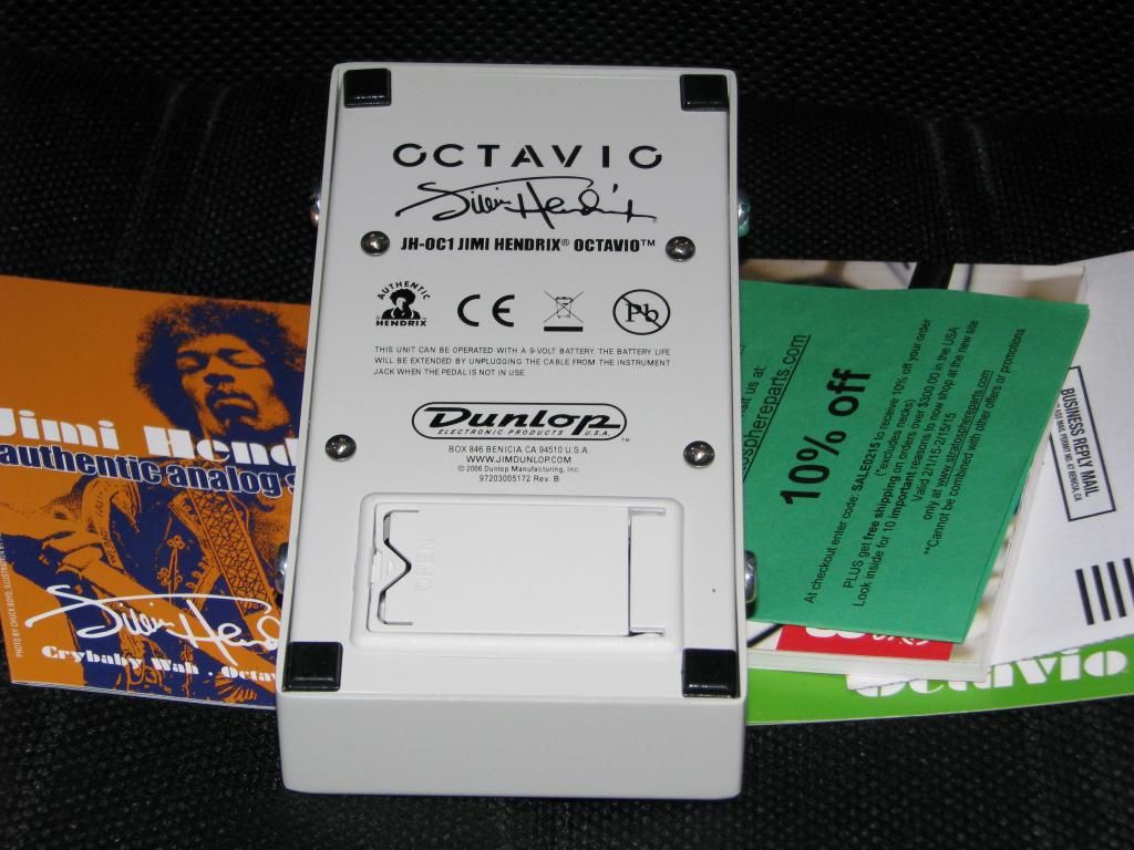

So my Dunlop Octavio has a funky bottom plate that's counter sunk into the upper body housing, so I cannot just velcro it to my pedal board like my other pedals with flat bottoms. I need to think of some way to make up the gap that won't damage the pedal.
My initial thought was actually to utilize the holes for the 4 screws you see there in the bottom of the pedal, get some longer screws with the same width/thread, and drill holes though my board to mount it. But that would be a total PITA since the pedal is battery powered, so screw that shit.
I need to make up the space between. I've done double velcro on one pedal before, but it was a lighter pedal and spread out over a larger foot print than is available on the bottom of the Octavio. It's a fairly large and heavy pedal (~6"x3"x2", and a couple lbs easy).
Here's the bottom.
2nd thought was having someone machine a little plate to attach to it with the 4 screws which would not obstruct the battery compartment and I could put velcro there. I think it would suffice to hold it as long as it had a good bit of interlock with the velcro on my pedal board. Something to cover the entire area past the battery compartment so I could get a good bit of velcro on there. Lined with felt too so as not to fuck up mah sexy-classy pedal would be nice.

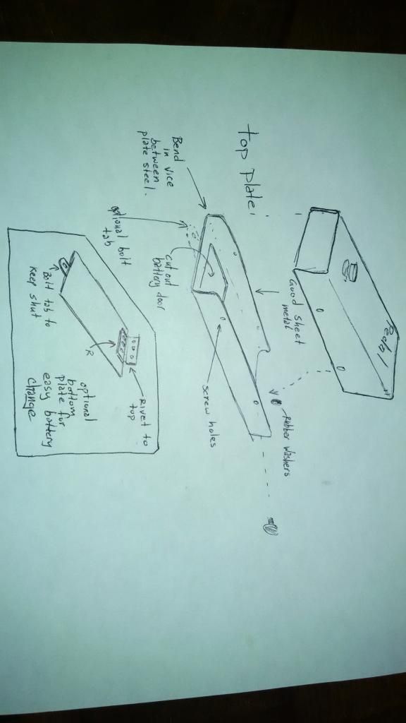

Get two little pedal sized sheet metal pieces, metal pipe clamps, pop rivets, and a hinge. Flatten the pipe clamps with a hammer, then using a makeshift brake, bend them at a 90 degree angle. Screw them to the pedal using the side screws on the pedal (rubber washers to protect the paint). Pop rivet the brackets to the first sheet metal piece. Then pop rivet the hinge between the two slabs of sheet metal and put Velcro on the bottom side of the bottom piece. Now you can flip and change the battery without needing to unlock Velcro.
-Ring Mods!

Hang on, its countersunk but not plush with the edge of the case?
Fuck that.
And no 9v adapter barrell?
It looks plush from that photo, just be selective and careful when you cut out your velcro.
