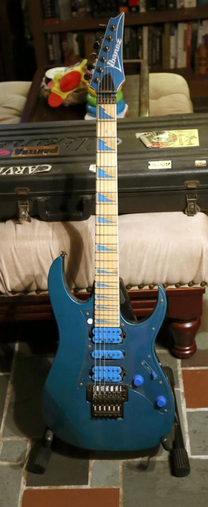

My only experience with a locking trem is the "Lo-Pro Edge" on my '93 Ibanez 770dx. It's a Floyd Rose at the core, but it's engineered very ergonomically. It's also the type that you clip off the ball end and then clamp the string in the trem block with a screw/allen key. Works great overall. Tuning stability is outrageous on that thing. I actually used to play Rage's Fistful of Steel and do ALL of the divebombs manually (like Tom does 'em), and it never went out of tune even a tiny bit. Thing is outstanding.
However, it is a bit finicky. The only way it works for me is if I tune to E or Eb and use strings that are 9s. Anything else and the balance is out of whack, and I can't adjust the springs enough to compensate. I'm sure an experienced metal tech could get it working with other tunings and strings, but I'm not a metal tech.
Here she is:
Here she is:
