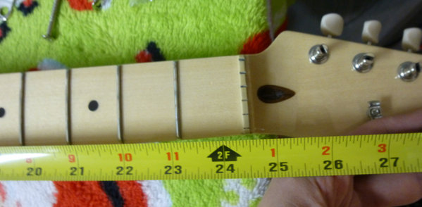

I actually had a CV Duo Sonic here and tried the neck...it's darn close!
Here's the CV Duo Sonic neck on my 25.5" Fender, measuring from the saddles (set for 25.5" scale) to nut:
The saddles would run into the trem mounting screws (and I think right off the bridge plate) if adjusted to 24" scale.
But I think the CV Duo Sonic neck would work on certain hard-tail 25.5" Fenders. Depending on the size of the bridge plate and if you get/have longer intonation screws.

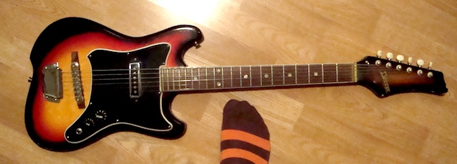

well... you could learn to love teiscos......

Mudfuzz wrote:well... you could learn to love teiscos......
I took a quick look, and I don't think that's gonna happen.
They've got the quirk, but it looks like they've also got the suck. I saw one on eBay, not modded, where the low and high E strings were at least 1/4" away from the pickup poles.

22" scale teisco made yo!
