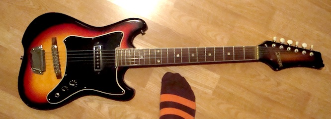

The problem is, the 22.7" scale has ruined guitars for me forever. :lol: Even my 25" scale / 1.7" wide nut neck on my other guitar now seems like a vast expanse of wood!
Posts: 16705
Re: Short(er) scale conversion necks...?
Tom Dalton wrote:The problem is, the 22.7" scale has ruined guitars for me forever. :lol: Even my 25" scale / 1.7" wide nut neck on my other guitar now seems like a vast expanse of wood!
well... you could learn to love teiscos......

Mudfuzz wrote:well... you could learn to love teiscos......
I took a quick look, and I don't think that's gonna happen. :lol: They've got the quirk, but it looks like they've also got the suck. I saw one on eBay, not modded, where the low and high E strings were at least 1/4" away from the pickup poles. :wha?:
I did find someone in FL selling a great condition 90s Reissue Duo Sonic for $200 OBO...but he wont ship it, only local pickup. :cry: I'm broke anyway, so it works out well. ...I kind of want to hoard a couple Duo Sonic necks.
Posts: 16705
22" scale teisco made yo!
