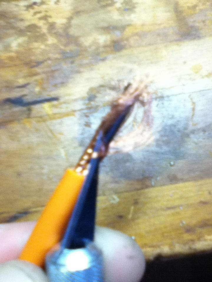

im gonna throw up a picture
but as my bad luck dictates the stress in my life
the shielding in the cable i have is braided
almost like that flexible wrap he put around it
so when i strip it it doesnt just untwist nicely

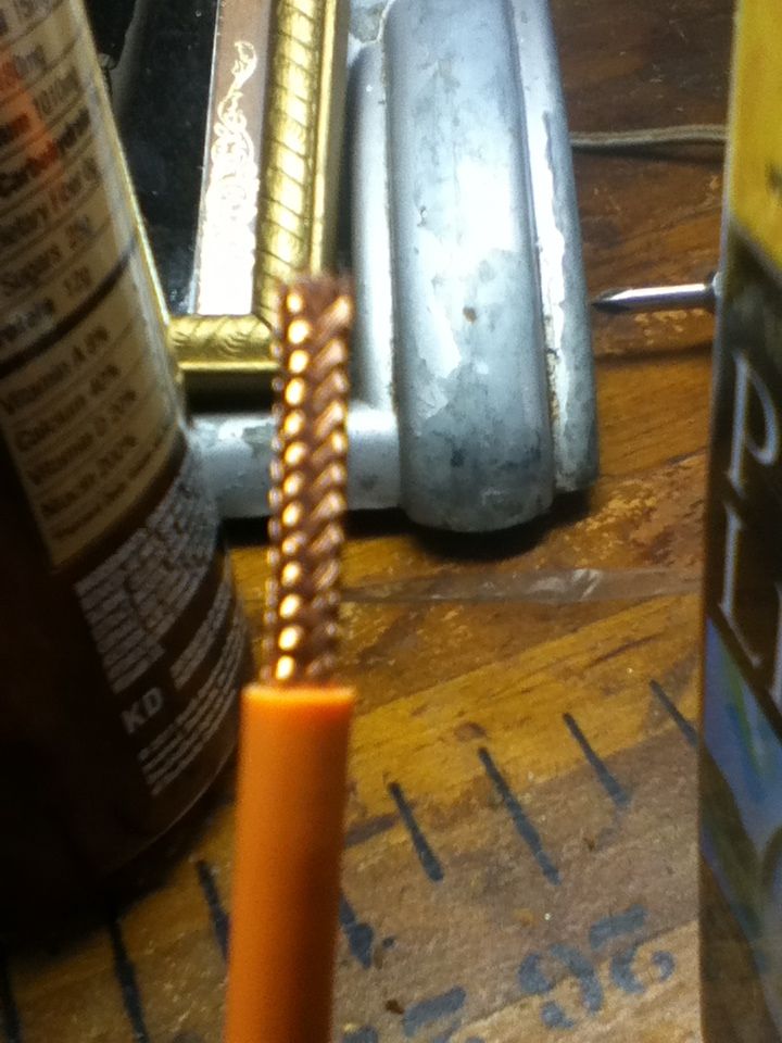

this is what im talkin about
i figured out how to deal with it
used an exacto knife an unbraided it down one side
next time im gonna use something round like a nail
to not get hard bends cause a couple broke off
problem solved
