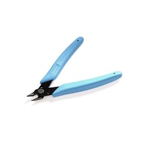

eatyourguitar
Posts: 3127
Location: USA, RI
Re: So I have this friend...
Post by eatyourguitar »
flush cutter on amazon
much better than the nail clippers I was using. use the flush cutters for component leads and wire only! get something else to do all your heavy cutting.
