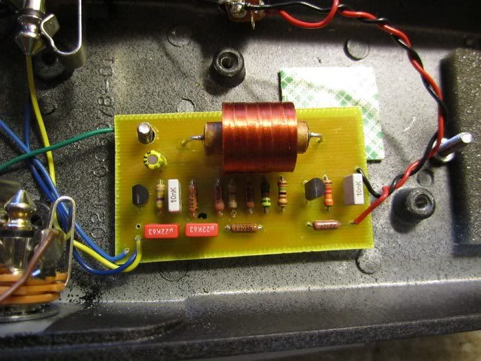

I'm working on a new wah PCB layout (Clyde McCoy). I found some cool axial inductors for cheap at Mouser. But they turned out to be too noisy to use for a wah. :(
I can't decide if I want to try to wax-pot the inductor or just give up and redo the layout for the typical radial lead inductors for wahs.
Anyway, here's what the axial layout looks like:

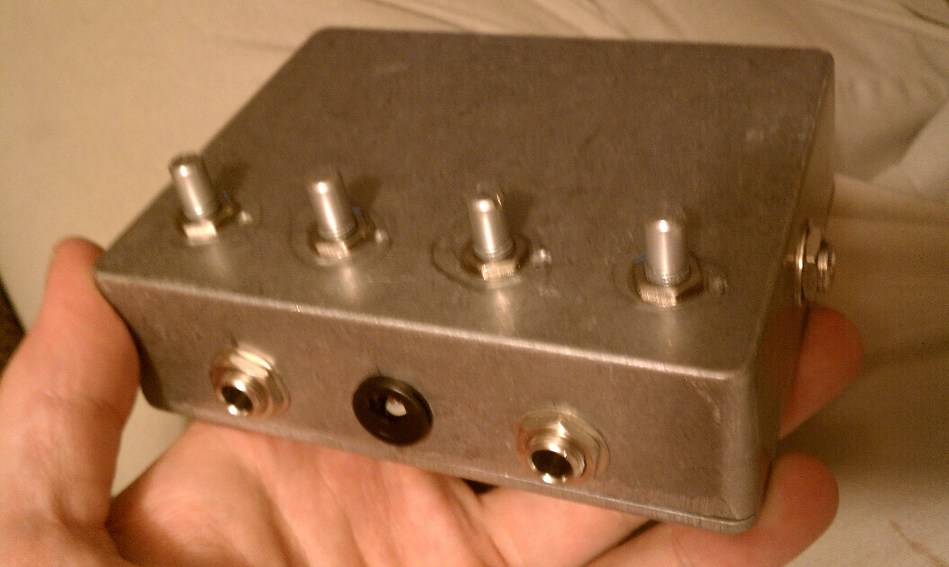

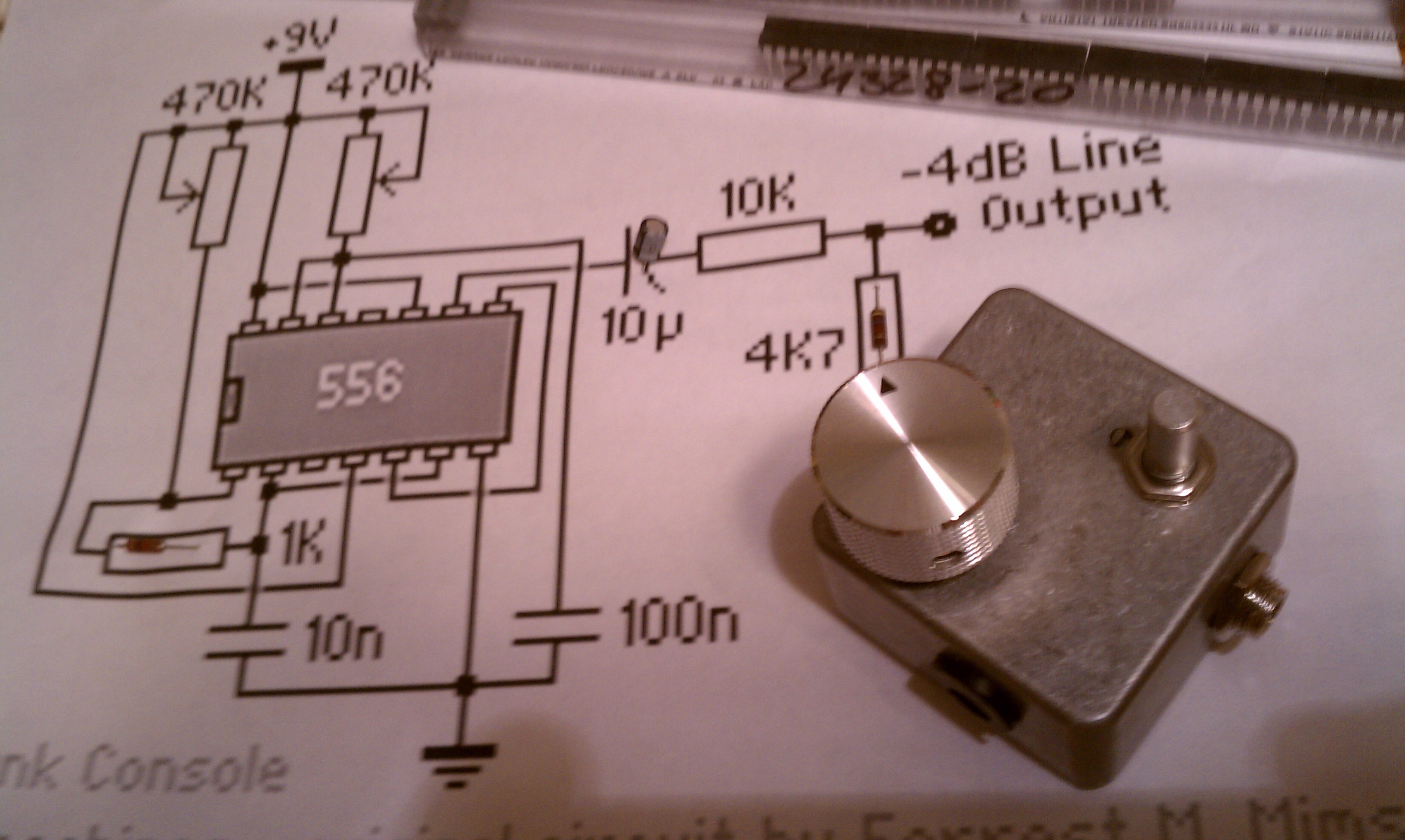

parallel universe (new one) and a little atari punk console. this is a difficult, almost impossible build due to the small enclosure but I think it will be worth it. its all there but the resistors, caps, 556. I do have the output and the dip14 socket mounted to the protoboard. the parallel universe is gonna wait for 3PDT's and LED's. no board in Parallel Universe yet although i do have all the parts. I need 100n and 10n caps for the APC and I need Knobs for everything.
atari punk console mounted in 1590LB. circuit redesigned by kaustic machines.
parallel universe
parallel universe
