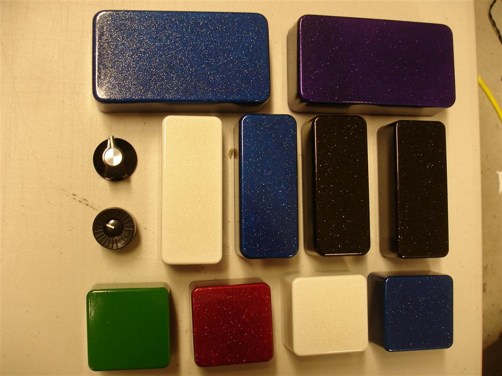

OK sirs, I got the stuffs in to make little expression knobs in a box...
Here's the haul and a couple knob options:
Helter
Posts: 1187
Location: Pittsburgh, PA
Re: tiny expression pedal to use with elements.
Post by Helter »
You said you didn't get white squares :cry:
Live your life like a tree.
Incoming
True pedge
Ryan
Posts: 5277
Location: Ogopogo Valley
Post by Ryan »
They didn't have white sparkle in their choices but I asked for it in my order note and they made it happen! So that little white one can be yours if you like, Brad.
Helter
Posts: 1187
Post by Helter »
:thumb: Totally Ryan, I'm just waiting for the PM to send you my cash! Loving the elements still by the way stacks so nice with everything.
