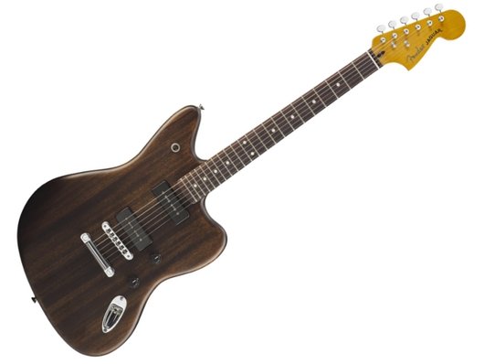

http://www.musiciansfriend.com/guitars/ ... 1042749763
This looks like a pretty cool guitar, but there are things about it I don't like (STRAT INPUT). I was thinking about getting a custom body made that was similar, with a P-90 in the neck, only. I like the look of a stripped-down, no pickguard Jazzmaster.
I looked at Warmoth, but I don't know if they offer bodies with routing like that. How does it work? Is it all through like tubes and tunnels in the body?
I'd basically want just the P-90 in the neck, like I said, with Tone and Volume controls and an input jack on top like a regular Jazzmaster; mahogany body. That's it. Pretty simple.
Any recommendations?

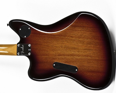

It looks like it's just routed like a Les Paul: Two cavities cut from the back for the controls and switch and two from the top where the pickups sit; interconnected by small tunnels for the wires.
asdf
asdf
(plates as evidence of rear routing)
I check the warmoth site and they won't let you get rear routed Jag bodies so, you'll probably have to look elsewhere.

bob the r0bot wrote:It looks like it's just routed like a Les Paul: Two cavities cut from the back for the controls and switch and two from the top where the pickups sit; interconnected by small tunnels for the wires.

Warmouth will pretty much rout any pickup combo/control cavity you want.
An extra long bit is used to drill the feed hole from the pickup to the cavity so no need for a pg.

How does it work? You drill holes with a long bit and through the through the neck pocket as much as you can the rest takes a bit to work out the right angles.
