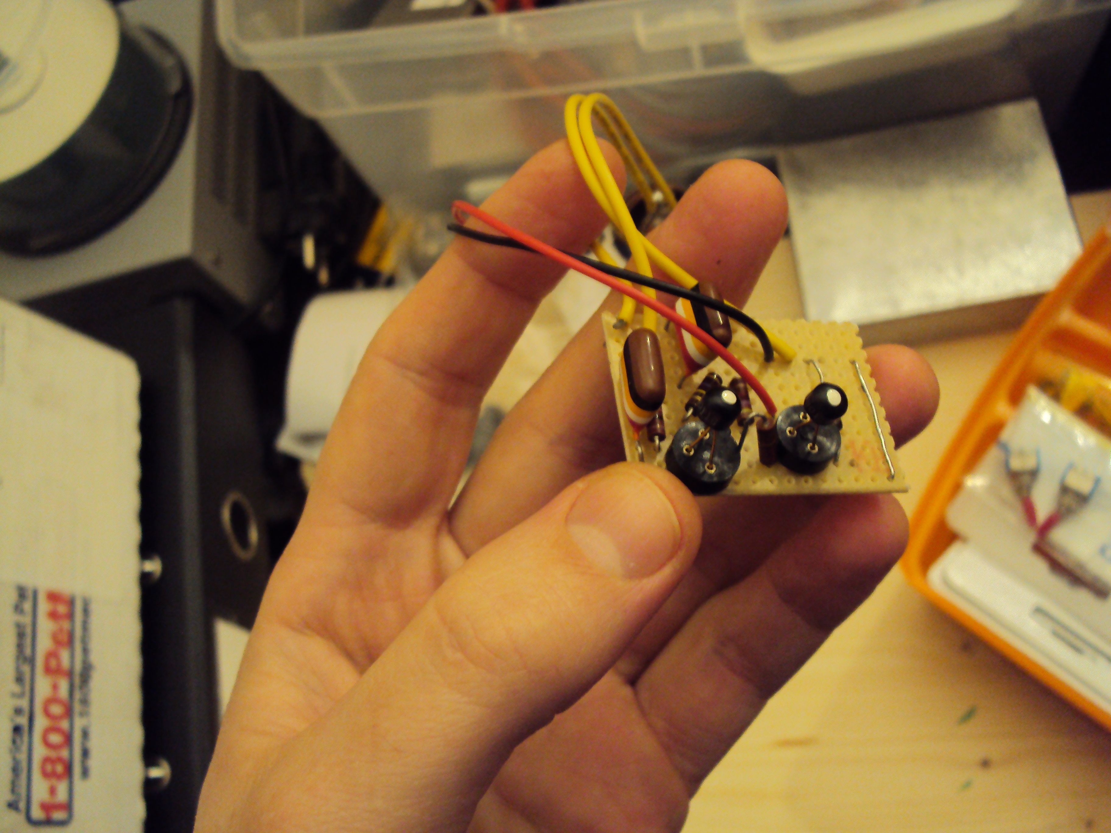

super simple compared to everything else on this thread but something i've been meaning to build right.
orange sunshine fuzz!i think it sounds nice and gritty but theres not enough sustain.maybe mess with cap values
or the resistor between t1 base and t2 emmitter?
i'll probably toss this aside once i get my snowflake pcb though.
- eatyourguitar
- Posts: 3127
- Joined: Sun Oct 03, 2010 12:37 pm
- Location: USA, RI
Re: WIP Thread!
Put a boost before it and you will have more sustain.
- eatyourguitar
- Posts: 3127
- Location: USA, RI
Re: WIP Thread!
thats one tight perf layout mmmHhhmmm
I'm gonna make a better layout for people so they dont have to torture themselves like i did.WWW.EATYOURGUITAR.COM <---- MY DIY STUFF
