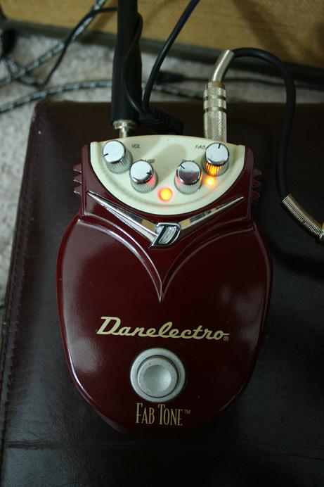

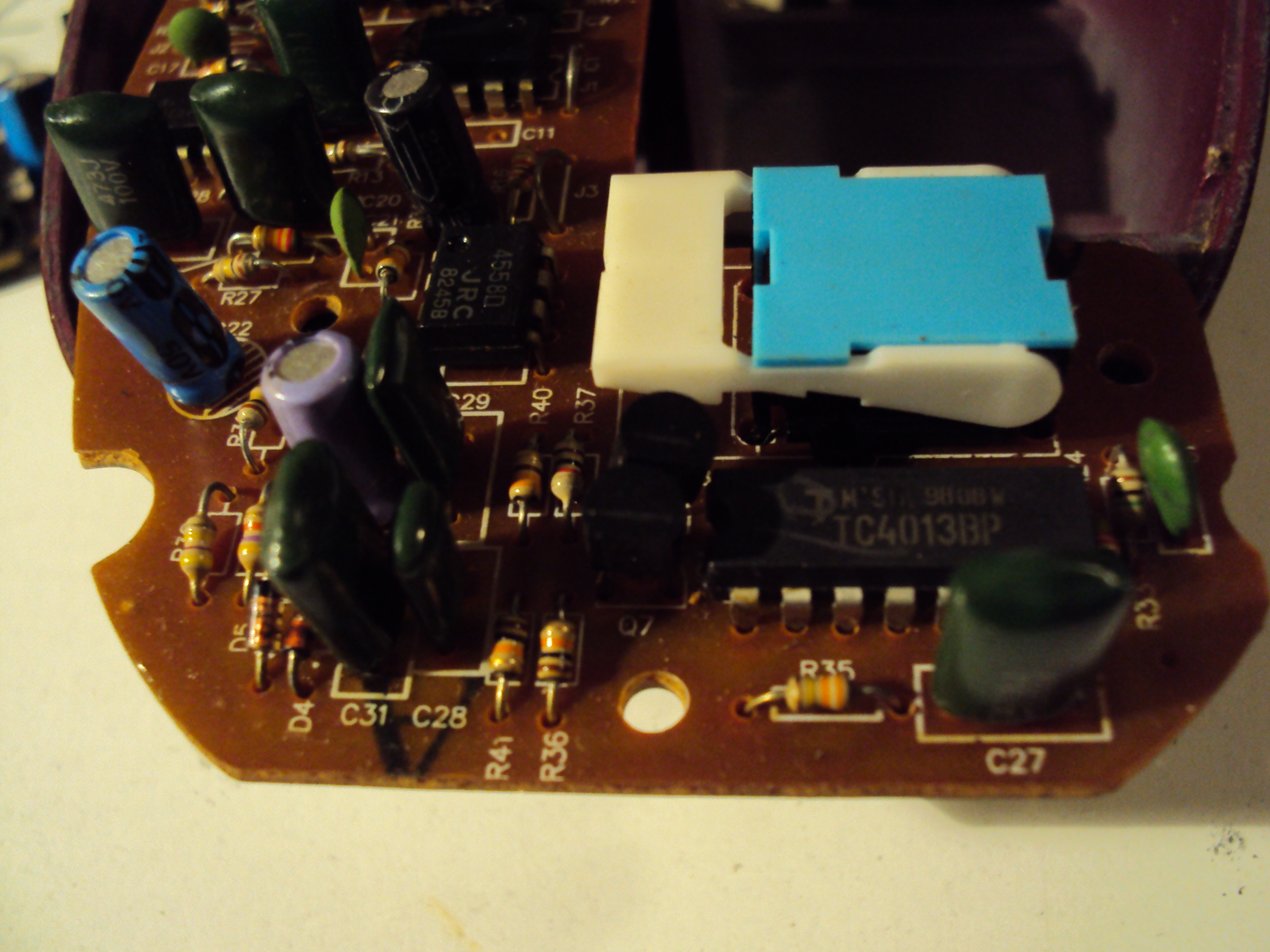

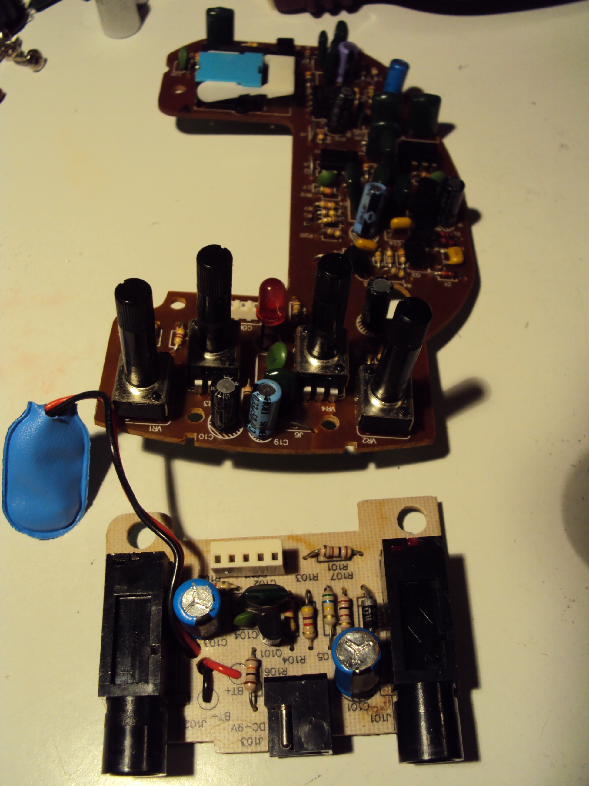

i was also wondering if anyone knows if a fabtone can be switched over to true bypass and also which of the caps (or other components )
can be switched out in order to get rid of a high pitch squeal that occurs when the treble knob is up or give it an all around bassier tone in general?

You'd most likely need to rehouse in order to do true-bypass...easiest thing to do would be to build a true-bypass loop and plug the pedal into there.

There's not a whole lot more to it than switching out the switches. If you look up 3dpt wiring and find all the points on your board/jacks you should be fine.

Need to decide if the buffer part of the circuit will be left in or not as well. As for having space for a 3pdt, you can take out the button/switch that's in there now and it will fit.
Some things I did for a "friends" Fab (which I still have and seems will nvr get rid of)...removed c5 (scooped the mids a bit), discrete switching from led/diode or asy 3 diode clipping. The led lights up based on pick attack & "fab". Went through several to find a good one. If you remove the clipping altogether, it will have more range (od through distortion), instead of just DISTORTION. You can still get that overthetop sound with the "fab" cranked.

yes the buffer part is what im trying to eliminate.it seems to really take away from the signal.i guess ill have to poke around.
Im defintely going to see what it sounds like without the c5 cap.does that mean you just replaced it with a jumper?
