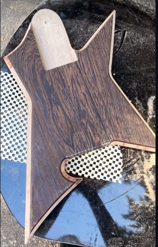

dubkitty wrote: ↑Fri Apr 03, 2026 9:00 am
will that neck pocket accept the neck? or is it wider commensurate to the fingerboard, in which case it's routing time?
Routering this prefinished body means no sanding or finishing and I’m already knee deep in an extreme body build….
