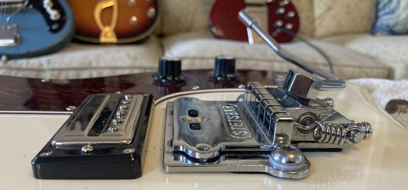

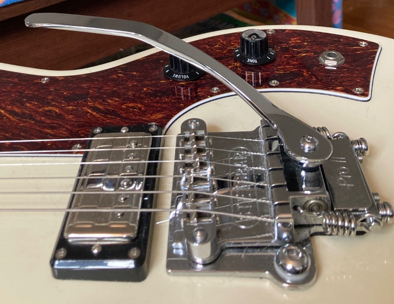

started working on the Jetstar last night. i’m always nervous around power tools, but drilling out the holes for the new anchors went about as well as i could expect. the largest drill bit i own was just the right size to be able to seat the anchors by gently tapping them in with a hammer. i took care when tightening the bolts not to over-tighten them and pull the anchors out. the flat orientation above the body surface is correct; there’s a rubber pad under the bridge plate that keeps it from rattling against the body which dictates the distance.

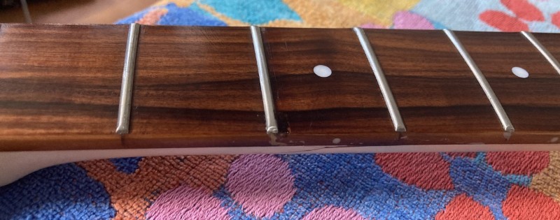

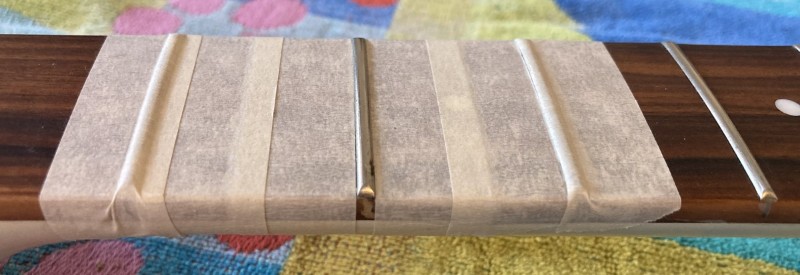

the next thing is the 2d fret. i taped off the area last night before i went to bed, but i’m not feeling precise enough to fuck with it until i have some coffee. you can see that it's uneven and taller than the other frets just by looking.

i finally managed to crank up my courage and do the fret sanding. i think it turned out well—my small ruler as a straightedge says the tops are even across frets 1 to 3—but i don’t want to put the strings back on yet because i have to do the bridge/neck pickup swap which entails pulling them and the pickguard and resoldering the connections. it needs a little more detailing, but i'm not up for that right now. i'll get it before restringing as part of double-checking everything i can think of. it’s funny how i’m having to do everything i always worry about fucking up on this guitar…fret work, rewiring, drilling great big holes, and fussy finishing work. i console myself by looking at the work i’ve done on the other projects and reminding myself that i actually can do this because i’ve done it in the past.

i still need to do the intonation and diddle around with the truss rod and bridge to improve that action if possible, but all the functional repairs are done and everything works. i should polish the second fret a little more, but it's no longer messing everything up on the first fret. i'm particularly happy that worked. the former neck pickup that's over 7 kΩ is nice and snappy in the bridge position, and the 5.2kΩ pickup that's now at the neck keeps up with it just fine. i'll work on the tiny adjustments later today, but probably won't get into the finishing stuff for a couple of days because i have stuff to attend out of town. Stetsbar sells a "vintage style" handle i'm going to order because it looks like it'll be more comfortable in my hand than the oddly twisty "modern" handle that's standard and goes better with the Jetstar's modern-yet-ancient vibe.

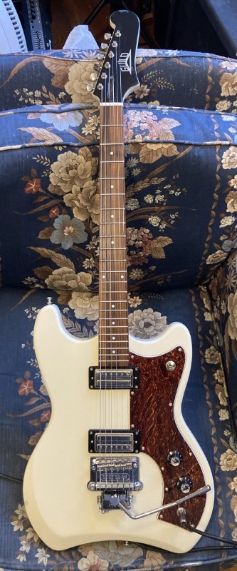

here’s a group shot of everything i worked on since February.
Kondor: body repairs, removed tone control, headstock sticker
Jazzmaster: restrung for C tuning to experiment with baritone
SG: replaced bridge, tuner buttons, vibrola, knobs
Jetstar: redrilled tailpiece anchors, sanded 2d fret, swapped bridge and neck pickups, body fixes to come
Hopf: assembled from Hopf parts from multiple sources, sanded fingerboard, replaced pickups with Jupiter 62 pickups.
Aristocrat: adjusted pickups.
also adjusted pickups on the White Falcon, not shown.

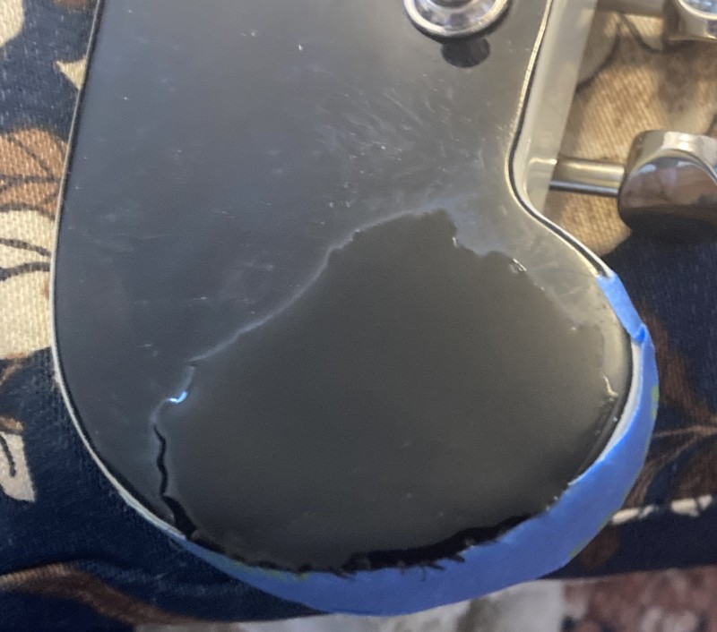

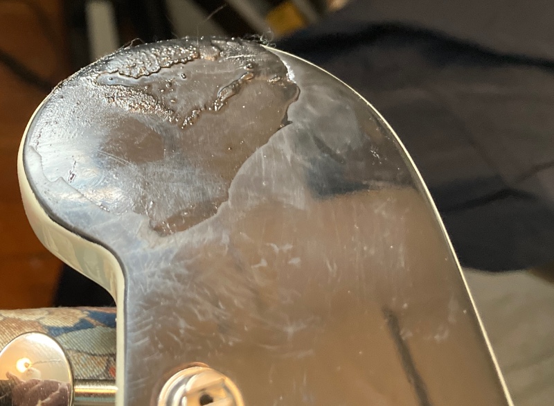

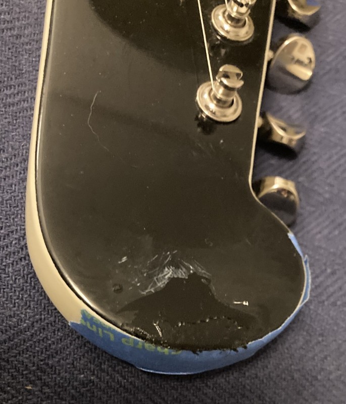

getting started on the body/neck repairs. i decided to do the smallest, least obvious place to start which is the headstock. as previously noted, i think the neck got broken when the guitar fell off a holder high up on a wall. the damage consists of 3 areas: the back of the neck where the break was provisionally repaired, a large ding on the side of the left lower bout, and the headstock. i'll be using tinted medium-consistency cyanoacrylate from StewMac; i aim to fill the black part first, building it up till it's level. after that i'll do the white part.
i taped off the white edge to keep the black glue from getting into it, making it that much harder to cover.
the glue is pretty thick, and seems like it'll fill in space with not too many applications. i'm deliberately making the glue higher than the face of the headstock so i have room to sand and polish.

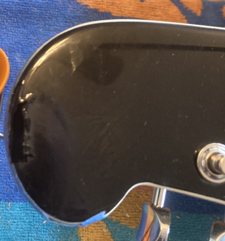

the first coat came out lumpier than ideal. second coat is better, but still not as smooth as i'd like. i'm letting each coat dry for several hours, so i won't do the third coat till tomorrow. this is playing hell with my impatience, which i always battle when doing this stuff. i doubt i'll start sanding/polishing until Wednesday at least. i want to finish the black face of the peghead before i start on the white so the outside edge is established. you can also see how the division between the black face and the white sides of the headstock has to be established. i deliberately didn't go past that dividing line when taping, even though i might have done better at building up depth if i'd made a sort of dam at the edge. trying to figure out as i go what's the best way to deal with these problems.
you can see how i'm adding extra height to the crushed area so i have room to sand everything down to smooth. i'll probably extend the glue out to the scratched area just outside the glue line in hopes of saving having to sand/fill that area as well.
i'm going to order some cyanoacrylate (hereafter, "CA") accelerator to force the glue to dry faster before i start on the white stuff. i want to get the smoothest coats possible on those areas, and you can see how the thickest area towards the tip of the headstock is raised and irregular because it was deepest and dried last. i really want to get this and the Double Jet done soon because they've been hanging over my head for awhile. hope they don't emulate the guitar and fall down while hanging over me head.

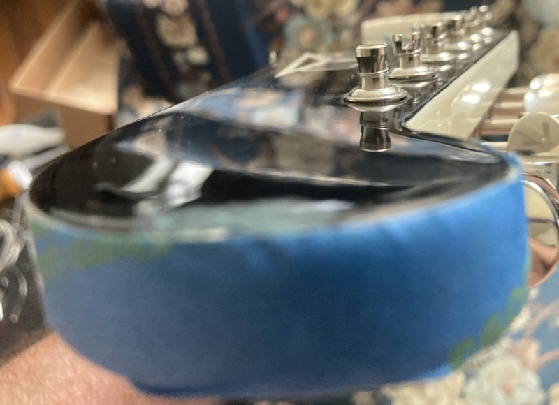

i just did the 3d coat of black CA on the headstock. as you can see i moved the perimeter of the glue area outward to cover some of the deep scratches. it looks like the edge is now thick enough to be worked on, though it may be different when the glue dries. i might get to work on the finish tomorrow, but it's more likely to push back to Friday or later because i'm going to see Underworld in New York on Thursday and have an optomologist appointment Friday at 3 to be evaluated for cataract surgery. the present-day composer refuses to go blind!

the third coat of black CA has the same crusty character in the thickest bits which dried last as the preceding 2 coats. i’ll start on the headstock by using the sanding block to level off the high points to a flatter surface that can be hand-sanded and polished.
