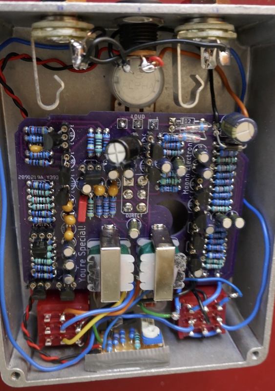

Some interesting stuff from Moonn.
First, a PCB that's supposed to recreate the Honey Special Fuzz, a Japanese thing from the late 60ies, it seems.
No idea what they were on while designing this, I mean you have 13 transistors, 2 transformers and a shitload of other components in there and all you get as far as potentiometers go, is a volume control at the very end of all that circuitery!
It's 2 things (if I'm not mistaken):
- a fuzz circuit, à la Superfuzz and
- an autowah (?)
The toggle switch let's you choose the routing, so to speak:
- up = left foot switch kicks in both: fuzz into wah (right footswitch does nothing)
- down = left footswich kicks in fuzz only, right footswitch activates wah only, while taking the fuzz out
At least, I think that's what's happening ...
The fuzz is pretty beefy and cool, the wah is kinda wonky, but then, I have zero experience with wah circuits, so what do I know?
I tried a lot of transistors in the wah section to get a presumably nice wooshy movement. I also fiddled with the transistors of the output section to get more volume because it got just a bit over unity when dimed. But that didn't really help, so I just added a LPB-1 (on vero) after it and now it roars!

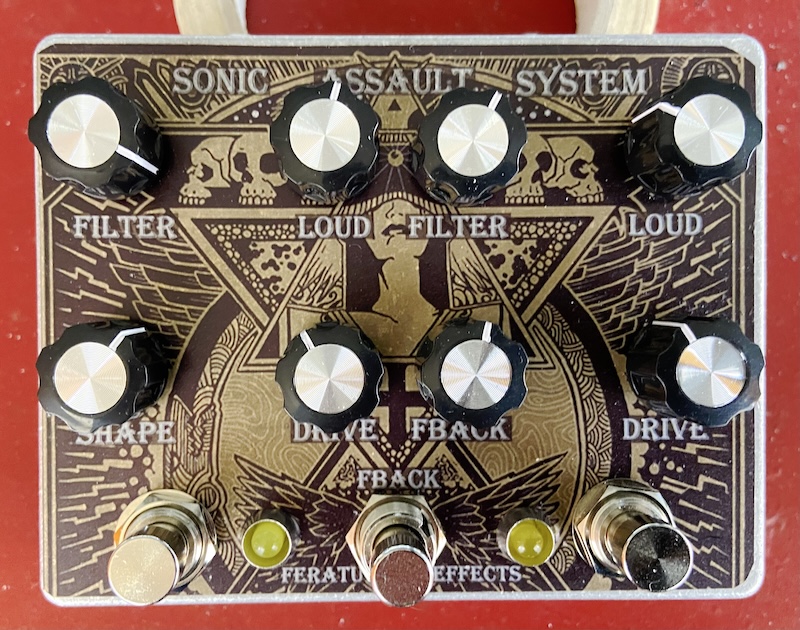

And then, the SONIC ASSAULT SYSTEM . Its supposed to be a one-off DBA thing called Assault System.
Those 2 PCBs might or might not recreate a pedal that might or might not exist and that Mr Ackermann might or might not have built just for himself.
First comes the op amp side, that has a feedback footswitch. I decided to use a momentary for that. Funn)))!
Then there's the transistor side. I had to try different transistors. 4x 2N5088, like the build doc suggested, didn't work for me. The signal would gate, sputter and even cut out on some filter/shape settings, also it was not loud enough.
2N5089 for Q1 and Q2 and 2N3904 for Q3 and Q4 sounded pretty good, so that's what's currently in there.
Having to try different transistors to make it work might suggest that it actually is a DBA thing

Interesting. Too bad they didn't take the time to make a better clone. I'll explain...fuzzonaut wrote:Some interesting stuff from Moonn.
- an autowah (?)
As the owner of two original units (still have one), as well as having traced it, and cloned it, here is my 2 bits regarding the Honey Special Fuzz;
- On the original, the Special Direct on/off switch basically turns the fuzz on/off. So, when effect is engaged, you either get "Special" fuzz/wah (or more like "fuzz/whoosh"), or just the "Direct" whoosh effect on the dry signal.
- The original units had very anemic output. With the volume at max, you're still a tad below unity. On the second original unit that I still have, I designed a small vero that carries the last stage of the Superfuzz circuit, and grafted it in on the backside of the circuit. This brings the volume up considerably, making the effect much more usable in a chain setting.
- The choice of using the 42TM013 transformer in the Moonn project is interesting. When I built the first clone years back, I tried lots of TL/TM series audio transformers (including the 013) to emulate the performance of the 4H TDK stack of the original, but at best, the whooshing was weak and/or muddy. Back then, I could have sourced the real deal TDK's from a Canadian supplier, but the $16 a pop and limited supply wasn't ideal for DIY. Eventually, I found that the secondary side of LT44 transformers (outer pins) were really close to the original performance. Not the same inductance or resistance as the TDK's, but the best performance of any of the other transformers I tested. Also, you can try playing with the 100nF cap just before the transformers (Moonn BOM C11). I found with the LT44's, upping a bit to 120nF made it a tad better. YMMV.
- While the original has a good chunk of the Superfuzz genetic, the lack of a tone switch or adjustment, makes it pretty much one dimensional. On my clone, I added a SWTC network, which makes it a bit nicer to dial into a chain. Again, the tone section is another volume suck, so even more reason to add a post amplifier section.
Like I said, I've been blessed to have had two of these very rare birds, at different times. The first I traded for a very nice Civil War Muff. The second came along some years later, which I found for sale on a Japanese site, in dire need of restoration. After refurbishment, it now resides in it's "forever home".

digi2t wrote:Interesting. Too bad they didn't take the time to make a better clone. I'll explain...fuzzonaut wrote:Some interesting stuff from Moonn.
Thank you for that explanation, makes things a lot clearer. I'm fine with the fuzz part, now that it's boosted at the end. Sure, it's a one knob fuzz and has just the one sound, but I dig it.
I'm still not impressed at all with the wah/wosh part of the circuit though. It is also kinda weak, as you pointed out. I might try to play around with C11.
But first, I'll get the Zupperbee done
