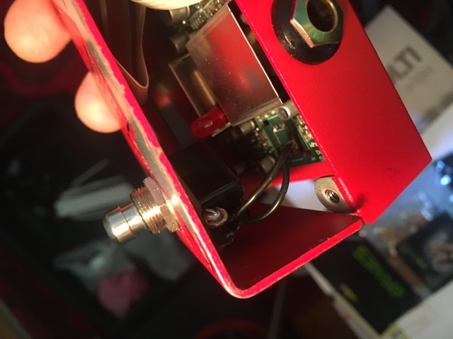

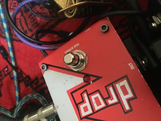

Nice work! On my Digitech Drop I completely replaced the switch with a momentary soft-touch footswitch. Totally worth it.
Place inside the pedal is tight but there's enough room.
