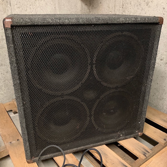

Want a cheap 410? I’ve got a Carvin that I’m not using and originally got for cheap - and I’m going to be in MTL once or twice this month.
It’s heavy for it’s size, needs one of its handles replaced, and is generally unattractive. Provided I can unfuck my back and get it up the stairs, throw me $50? for gas and it’s yours.

Damn doomeow thanks for the offer ! But the thing is, I'm already kinda worrying about the space available for the SWR (if I do get it... the guy should come by on Friday) so I don't think a 4x10 would be a good choice here. My amp is kinda jammed in between the mixer and a drumkit, and it's already kind of a tight space to get to the drum..
