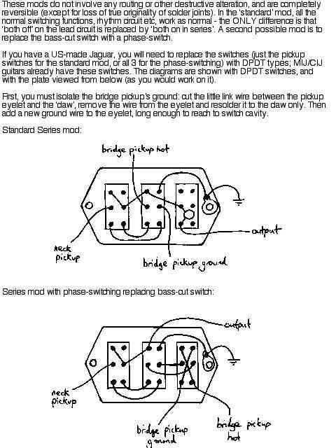

There are a couple of useful wiring-related mods that only cost you some time and a bit of wire :
- Wiring the two on/off switches so that you get both pickups in series when they're both down (instead of no sound)
- Replacing the strangle switch by a phase control for one of the pickups (which changes the sound when they're both on, series or parallel)
I did that on mine years ago using this diagram as a base, it worked fine :
Also, while you're at it, shielding the pickup/controls cavities with copper tape is a good thing to do. Get the tape type that is conductive on both sides so that you can make them overlap to keep continuity, and don't forget to make the copper tape overflow a bit on the top to that it gets in contact with the bottom of the pickguard. You want a continuous ground connected box around the pickups for shielding...

oscillateur wrote:My Fender Japan Jaguar looks quite like that (slightly different whites though) :thumb:
[/attachment]
I've seen some of these mods, but I like the way all the Jaguar switches work. I think I'm one of the only people who doesn't see the Jaguar's original design as a collection of things that need to be "fixed".
I appreciate the tips, tough, and I'll keep them in mind if there's something I feel is missing down the road. I do like the idea of phase switches, but not if I have to lose what's there now.

Even if you like the way the Jaguar works buy default, wiring it so that the two pickups switches down give you both in series is a good thing to do. You don't remove anything, you just add a new sound.
