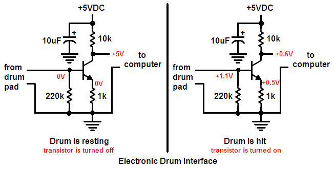

Re: Diy drum triggers?
Yeah what kind of trigger does the makey makey want to "see?"
First I'd guess you'd need to load the piezos so you're not getting constant triggers from ambient noise. You want the impulses from the playing attack to generate the desired responsiveness. And you want some simple Logic that "goes high" for a preset pulse length when "told to" ...What is "high" you ask? That is where you want your pulse to be. You want its peak somewhere below the maximum voltage the "makey makey" wants to "see" at its trigger in. And how long should your pulse stay high?
These are fun questions to think about.
- controlFreak
- Posts: 110
- Joined: Thu Aug 30, 2012 5:38 pm
- Location: North Carolina
Quick Google search was very helpful for finding a few schematics to experiment with.
