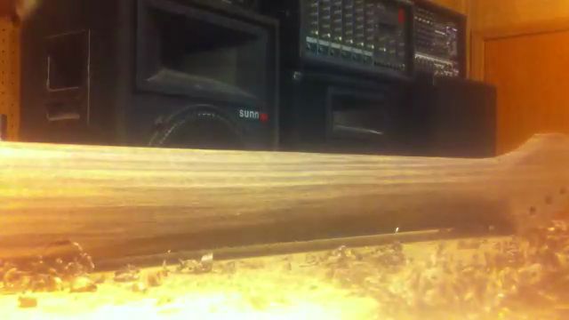

A little shakeycam footage of how I shape my necks for those interested in such things
Progress is happening. Fingerboard is mostly leveled and radiused, fret slots are cut, headstock is thinned to almost final thickness, and the contouring has begun. This piece of wood is working like a dream, too. No weird movement, it isn't chipping or having ridiculous tear out, and it isn't murdering my tools. I like it when things work nicely.
