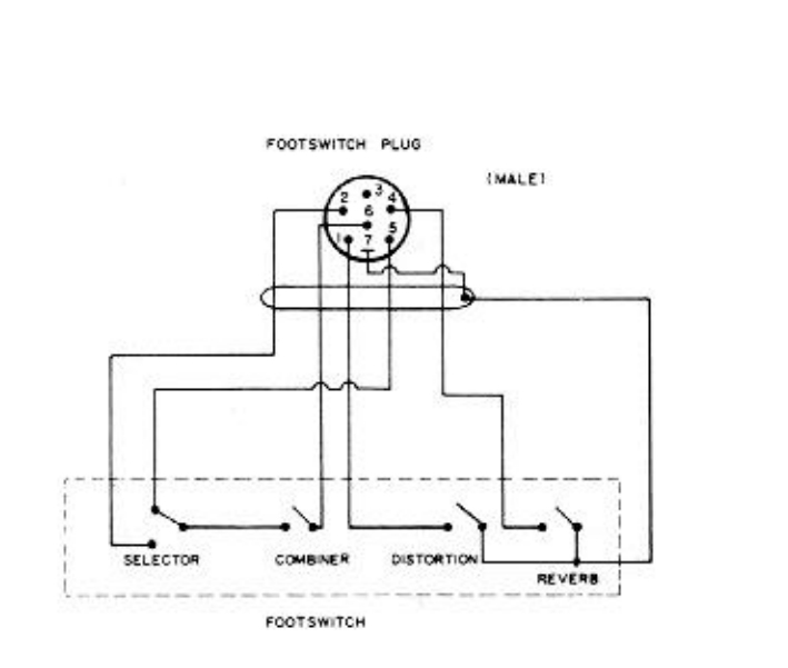

Anyone know how to make one? I have a peavey musician 400, which has two channels and phaser and reverb. I know there is a foot switch you can buy on ebay, but it's like $90 which seems crazy. Anyone who where I could find a schematic? I've searched, but this will be my first build and as a rookie I don't think I'm searching ver well.
Seems te think that will make it tricky/weird is that it has a 6 pin connector, not quarter inch.
Any advice appreciated!

Re: Peavey musician foot switch?
This is from the schematic for the Peavey Standard, which is from the same era and I would imagine that they would be the same. You can take a small jumper wire and test whether it works or not.
