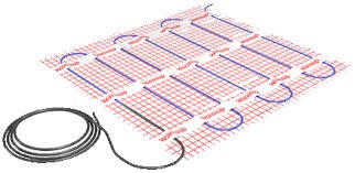

WARMUP HEAT MAT
it goes under the tile and heats the floor
having ground fault issues with it

pay attention when using that TDR meter. The heating wire is pretty certainly somehow woven in the heating mats, so you can have a few feet of wire per mat. Keep that in mind when calculating back to the place where the error might be from the measured wire length.

thanks schlate
this mat is a thin blue wire that snakes side to side
so yeah 4ft is only about 8 inches in
sounds like youve used these TDR meters,huh?
got any reccomendations ?
lookin for the cheapest one i can get
