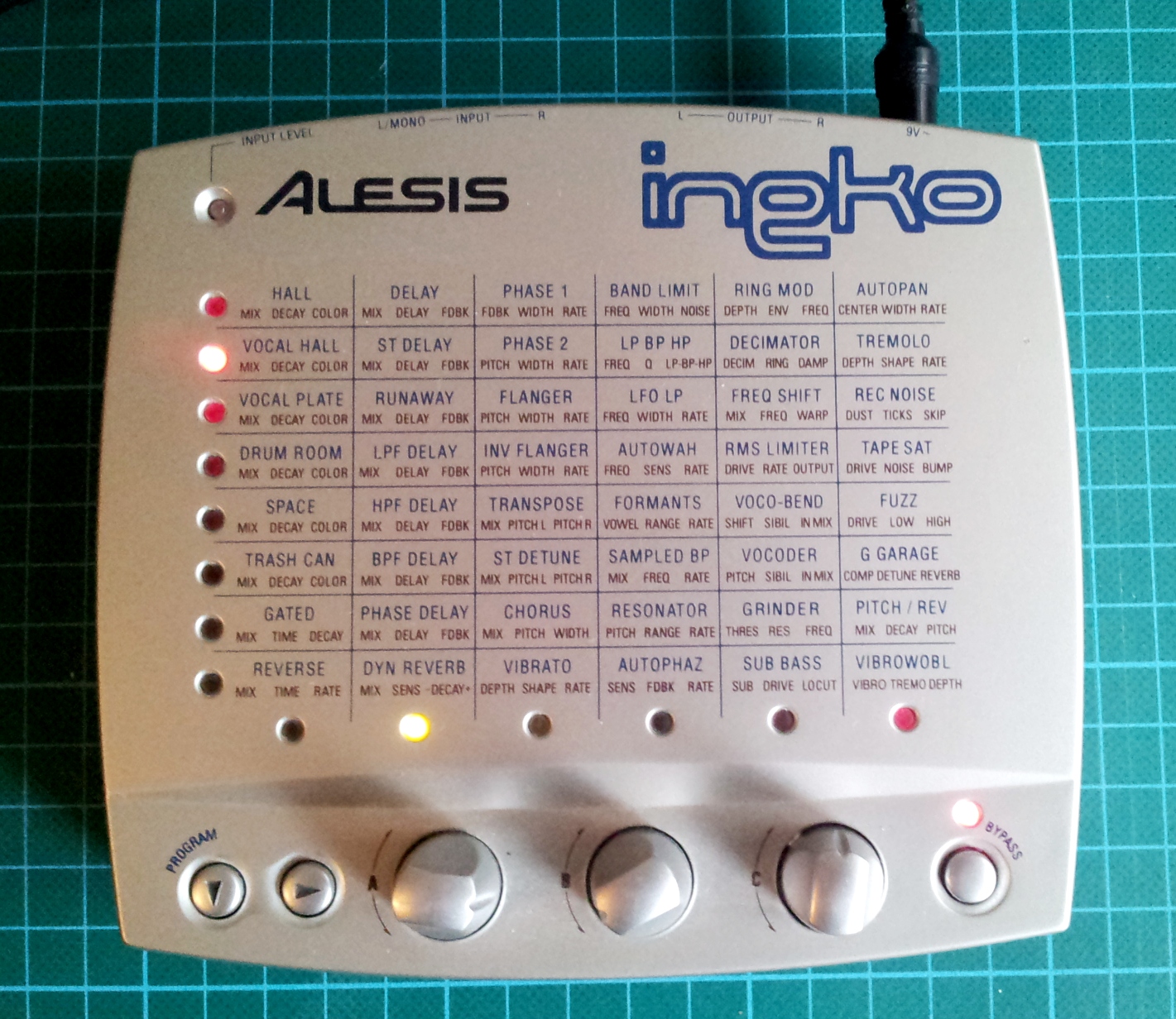

If you're a) open to desktop units and b) can find one to try/buy, KYEO for an Alesis Ineko.
9 Reverbs included space and reverse, 7 delays, and 32 other modulations, pitchshifts, and other fun noise tools. Idiot simple interface - program is map out on a grid, one button each to change column and row, three pots to control parameters. True stereo. A sleeper hidden gem for processing other sounds, in a feedback loop, in the loop of a delay etc.

that alesis box looks insanely cool, i would buy that in a heartbeat but searches are proving futile so that may take a long time.
