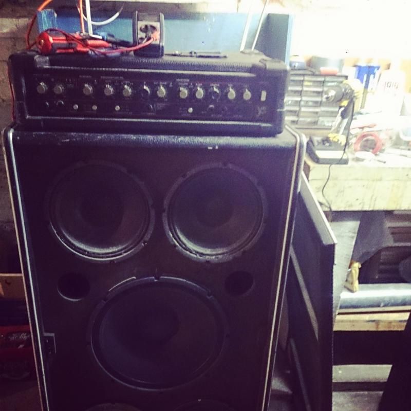

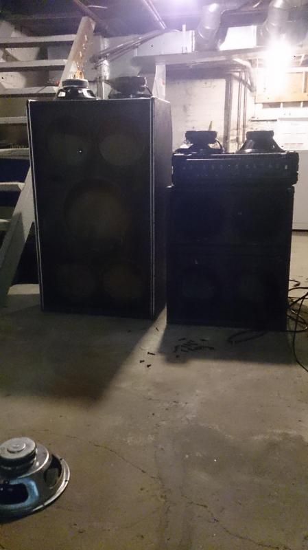

My bass cab recently crapped out and I can't really afford to replace it (I mean I can, I would just rather not) and my friend offered me his old Traynor fridge that has a 15" and 410s.
Here they are, together, hanging out in my creepy basement together:
I pull everything apart and test the speakers. Out of the 8 10" speakers 4 are working running at 6 ohms each when I tested them with a multimeter.
The 15" is working too, running at 6 ohms as well.
So here's the issue. My head is a solid state running at 8 ohms 250 watts.
The 410 was matched to the cab and ran at 8 ohms series/parallel
The fridge ran at 4 ohms, in the past.
So what I want to do is make a frankencab out of the fridge and run it at 8 ohms. I understand I can't just wire the 10s and the 15 together as that would run at 4 ohms. So what I want to do is wire 410s in series (or parallel?), and add a separate input for the 15 and essentially have a stereo bass cab running it out of the two outputs of the amp.
Does that make sense? Or am I going to blow up my amp and burn my house down at the same time?

retinal orbita wrote: So what I want to do is wire 410s in series (or parallel?), and add a separate input for the 15 and essentially have a stereo bass cab running it out of the two outputs of the amp.
If you haven't already, you might want to double check out how your external speaker jack works.
Putting a separate 8 ohm load into each speaker output may leave the head only seeing 4 ohms. Some amps have jumpers and/or switches to offset this.
If you're confident in those meter readings (6 ohm), I'm wondering if there isn't a way for you to series/parallel all 5 speakers and get into the 8 ohm zone so you only need one speaker cable.
This is really great advice - thank you. I just checked and it runs at 8 ohms, 250 w in parallel. So that would mean if I connect both cables to separate speaker configurations the head will drop to 4 ohms? I'm going to try some temp connections before I solder anything together.
