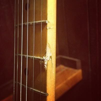

My beloved Esquire is getting the ever-loving-shit beaten out of it lately, and I'm thinking of getting a new neck. I could get it re-fretted and fixed and all that jazz, but I've never really liked the baseball-batt feel of the neck that came with the guitar (it's a MIM '52 reissue Esquire, btw), and it has that tacky feeling clearcoat crap on the back of the neck, which I also don't like.
