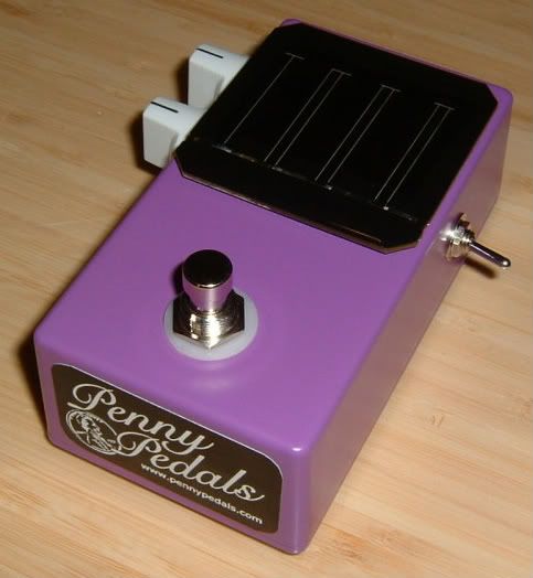

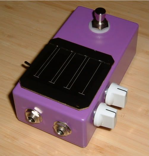

something i've been working on for a while, finally finished it up.
what is it?!?
it is a germanium boost/overdrive powered by a 1.2 volt rechargeable battery. the switch on the side goes from 'on' to 'off/charge.' the solar panel on the top charges the battery in the sunlight when the pedal is switched off.
the circuit is a modified LowFuzz with no voltage sag. the solar equipment was ripped out of one of those driveway/lawn lights.
controls are volume and low cut; it can be bright and clean or get a little nasty and heavy, just turn the low cut to taste for your amp/guitar. there's a surprising amount of volume for only 1.2 volts, plenty for a volume boost probably about 10-12 dB. it's pretty damn good sounding, i'll get some clips up soon.

Just how long will the charge last?

i played the prototype for about an hour, with no change, but i'd bet it will start to sputter out around 1 1/2 or 2 hours.
takes about 3 or 4 hours to charge up, just leave it in a sunny window. charged by the time you have breakfast!

Im so certain you can get cheap little panels for it. If you don't want to wade through mouser to find one, i bet if you find a b.e.a.m. robotics sight they would have some ideal little panels for a low cost.
P.S. is there any detriment to the battery for leaving it on charge for too long?

letsgocoyote wrote:Im so certain you can get cheap little panels for it. If you don't want to wade through mouser to find one, i bet if you find a b.e.a.m. robotics sight they would have some ideal little panels for a low cost.
coooool... i'll look into it. :cool:
the lights that i used have a small circuit board attached; it has a few transistors that switch the solar panel off when the battery reaches full charge, and turns the light on when it gets dark. i scrapped the dark sensor/LED but the over-charge protection is still there.
i wonder how long these can be re-charged? i've seen some of those lights go for years without problems.
