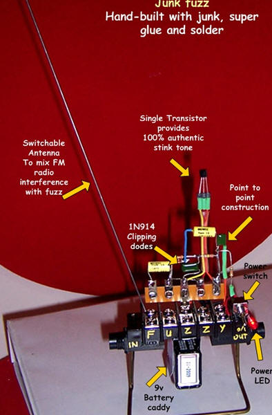

Post by TheAttackman »
starcastic wrote:I always thought it would be a pretty sweet idea to have a pedal that received radio signals on purpose with a dial and everything. Then maybe having a fuzz circuit and/or a bit crusher to manipulate the signal and the ability to dial your guitar into the madness.
God that would be awesome. Is it possible?
Beavis audio did something like that where he put an intenna into the pedal with a mix knob.. (itouch=no link sorry)
Michael schniker(I know that's spelled wrong..) once picked up a phone call such he answered thru the pickups...
( in lou of recent events.. :idk: :idk: too soon??)
When I'm breadboarding usually touching a connection gives me radio.... I play along with songs sometimes :facepalm: )

Post by smile_man »
TheAttackman wrote:Beavis audio did something like that where he put an intenna into the pedal with a mix knob.. (itouch=no link sorry)
:rock:
