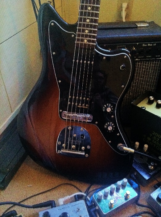

I'm super happy to finally get my hands on one of these at a decent price!
Picked one up today for $275 and the previous owner had a Gibson Dirty Fingers humbucker installed. It sound glorious!
Also it's basically new, still has some plastic on the pickguard and the string from the tag. Not a scratch on it.
IMG_0661 - Copy.JPG (207.74 KiB) Viewed 7476 times
Only problem is the bridge is god awful. The high e always slips from the saddle and is generally off the fretboard at higher frets.
The previous owner tried to "set it up" but he just couldn't get it to work, which is why he sold it.
So other than properly setting this up I'm thinking of replacing the bridge.
I read through the Mastery bridge thread and I got the sense that Staytrem or Mastery would be the way to go but, I have a Gibson Tune-o-matic bridge kicking around somewhere.
Would this work well?
Or should I really splurge and get a Mastery?
Or should I wait until Feb 24th when Staytrem start making their bridges again?

Congrats! Nice guitar.
I have a Mastery on my Jazzy and I love it, but yeah they're not cheap. You could always try a Mustang bridge, they're not overly expensive and if that doesn't fix things for you then think about a Staytrem or Mastery. The tune-o-matic I believe would require different bridge thimbles? Not sure but I don't think it's a straight drop in.

First off congrats on an awesome score! :thumb:
I'd skip the Tun-O-Matic honestly. You'd probably have to mod anyway to get a solid fit and they aren't that great paired with a Jazzy trem. Radius is wrong as well but could be fixed if you're good with a saddle file. I'd def do the Mustang bridge if you're deciding between less co$tly options.
Otherwise, Mastery or Staytrem is the way to go, no question. I own both and they're fantastic. Easy drop in installation and they correct ALL offset bridge issues. If you can wait, go for the Staytrem and save yourself some money but you won't be disappointed with either one.

If you enjoy spending money, the sound of rattling springs and constant tinkering with your guitar, get a Mastery. If you're looking to save a bit of money and want to install the bridge ONCE and forget about it - do yourself a favour and get a Staytrem. If you want to save a bit more money than that... get yourself a vintage or US-made mustang bridge that doesn't have the wee gaps between the saddles. PM me if you want to chat about it further.

Thanks guys, I'm definitely leaning towards the Staytrem but the Mustang bridge sounds like an appealing option.
Is a Mustang bridge able to just drop in without major modification? If so I'd probably be interested in the one you have Colin.

Yeah the Mustang bridge just drops right in. It is a set radius though, 7.25. Not sure if the Blacktop is 7.25 or 9.5.
Edit: Just looked it up, the Blacktop has a 9.5" radius, so the Mustang bridge is perhaps not ideal.

Hmm probably not ideal, thanks anyways.
I think I'll see if I can give it a good setup and hopefully that can last until the Staytrems are available again.

SO I just sat with it for like an hour and adjusted the height of the saddles + the intonation.
It is 100% better than what it was when he gave it to me. Still not great but it's at least playable.
I think I'll live until I can get a Staytrem :joy:
