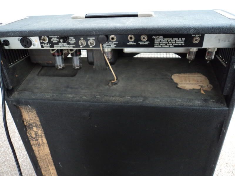

So basically I have this 70's Fender Bassman Ten (silver face, 4x10 speakers) - I need help with the following:
*Not sure which tubes to get, I think 6L6GC? Also unsure of the preamp tubes.
*Don't know almost anything about setting a bias - and not 100% sure how important it is.
So here is a picture of what my amp looks like (these aren't mine, but the same amp):
This picture is probably a lot more useful.
Anyways, help with this stuff would be awesome. I am pretty sure my tubes were microphonic when I got the thing like.. 7 or 8 years ago..I can't even remember.
