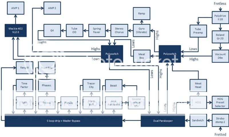

If you make thee sorts of drawings or find this intriguing, you might have a problem... I know I do.
I laid out the pedals before diagramming it out. I found a suitcase today that's the exact size I need. I'm hoping to finish this board officially over the next couple of weeks.

Wow, cool board and complicated too! I definitely see the need for a diagram with a signal chain like that. I use boring pedal 1 -> pedal 2 ->... pedal x -> single amp setups though because I'm too dumb for fancy routing, so there's no need.

I have my current pedal board in a scale drawing in Inkscape. All pedals are too scale. Every time I make a purchase I put it into the diagram and rearrange my board digitally.
1) it's nerdy fun
2) I have saved so much time and hassle by planning it this way. I used to hate winging it then being short half a pedal and having to rip up everything.
So in conclusion: your diagram rules and the whole process of diagramming a pedal board is awesome.
Re: Pedalboard Layout Nerdiness
Btw: I understand nothing of that signal chain. My brain refuses to compute parallel chains and especially fails to understand the key master. Unless you're incorporating a ghostbusters VHS in your rig. I get ghostbusters.

goroth wrote:Btw: I understand nothing of that signal chain. My brain refuses to compute parallel chains and especially fails to understand the key master. Unless you're incorporating a ghostbusters VHS in your rig. I get ghostbusters.
It's a secondary looping-only pedalboard for a folk/electronic project. The signal hits my ABY and A goes to the Keymaster.
In loop 1 of the Keymaster is a small Mackie mixer with 4 inputs. The first is my guitar, with highs dimmed and lows boosted, for when I use my baritone or Whammy Oct -1. Second input is a microphone. Third input is a banjo and the fourth is a wildcard, but most often an SP-404 Sampler. The mixer output (mono) then goes back into the Keymaster to close the loop.
In loop 2 of the Keymaster is a Boss RC-3 loaded with sampled sounds (ambient, motifs, etc) into a killswitch (I'll explain) into a Freeze into an M9 then back to the Keymaster. The idea with this loop is padding. I can use the RC-3 samples to create pads and use the M9 to manipulate them OR I can create a pad with the Freeze and manipulate that. The killswitch means I can keep the loop open and the pad going without having my guitar signal run through the M9 and be affected. I might switch the order of the RC/killswitch now that I think about it...
The Keymaster then goes out into the right input of another RC-3 (used for looping) then the right input of the Boomerang III then the A input of the Voodoo Lab Amp Selector which splits to a SF modded Super Reverb and an Ampeg Micro VR 2x10 bass amp.
The B of the ABY goes into the left input of the looping RC-3 then the left input of the Boomerang III then the B input of the Voodoo Lab Amp Selector which splits to a Dr. Z Maz 38 with 2x10 cab and an Orange OR15 with 2x12 cab.
I think that explains it all?
