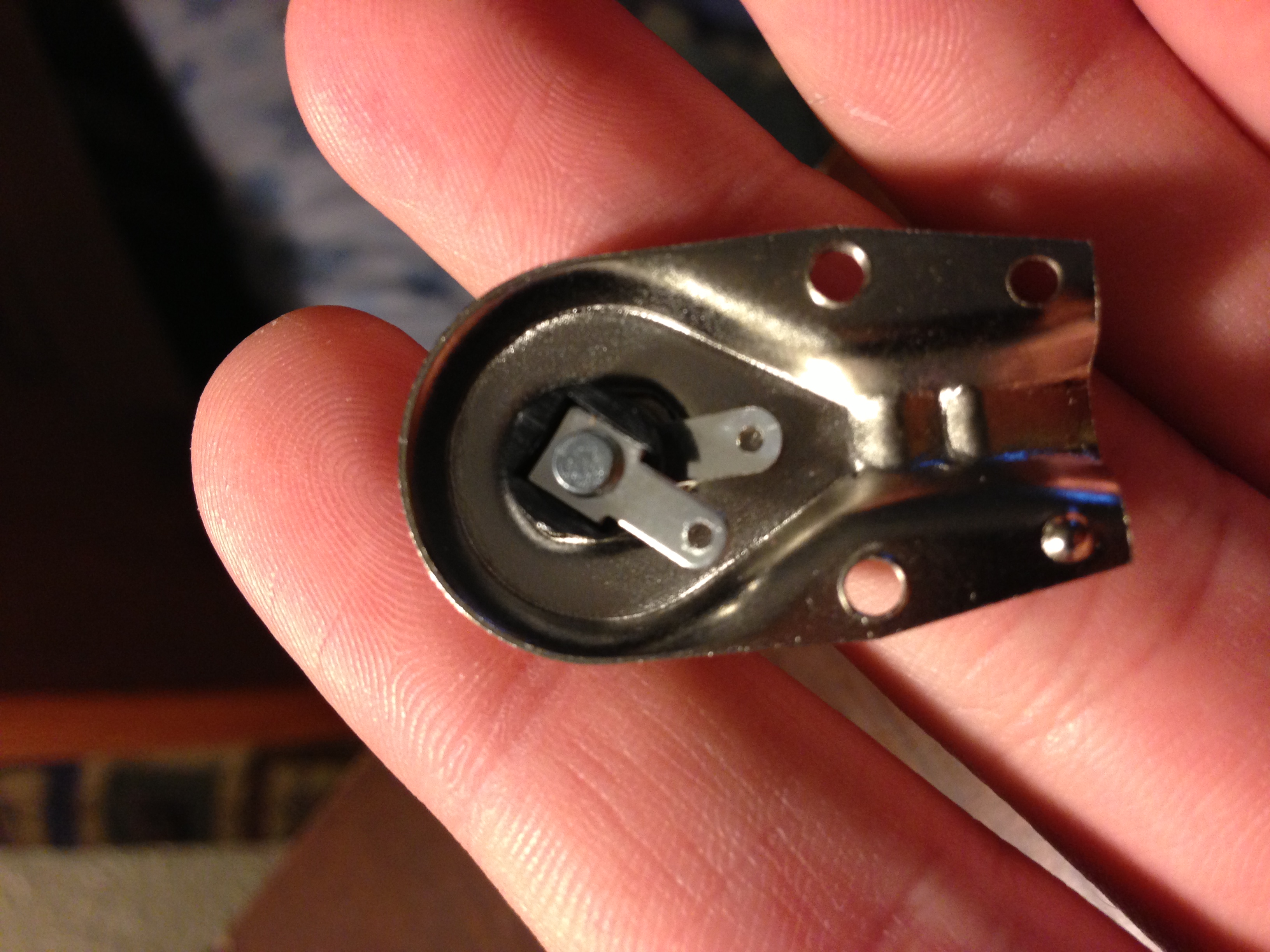

Alright, Imma diy nooblord so help me out, eh?
I've got these pancake plugs and some cable. I tried my first one today and I got the ends of the cable stripped, the shielding negative coppery stuff twisted and tinned, and then the middle positive stuff twisted and tinned. Then I started soldering the two coppery strands to different parts of the plug when I figured out I have no idea where to solder what.
So like an hour later, I never got the cables to work :(
So can you tell me which tab is what? Like tip/ring/whateva and then which one the positive side goes? And then how and where to ground the negative side?
And can someone tell me what grounding is? I have no idea. im hopeless

Um the center part is the Tip (+) and gets the middle part and the shield goes the the outer (-) one sleeve...

sonidero wrote:Um the center part is the Tip (+) and gets the middle part and the shield goes the the outer (-) one sleeve...
So the angled tab is the tip? And the shield goes on the other tab?

YES SIR... It's just cable, make a few and fuck up a few and it's no big deal... Make sure you only strip just enough to solder so you have enough outer jacket so when you put it back together it's got a good hold and wont wiggle and break later... Make sense???

sonidero wrote:YES SIR... It's just cable, make a few and fuck up a few and it's no big deal... Make sure you only strip just enough to solder so you have enough outer jacket so when you put it back together it's got a good hold and wont wiggle and break later... Make sense???
Got it, dawg! thanks! I'll chime in tomorrow if I have more trouble :thumb:

FUCKIN WORKED. Thanks sonidero! :D
