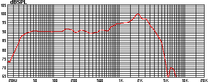

Beta 15":

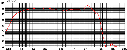

Delta Pro 12":
Peak with the Beta at 2K Hz, Rolloff starting right after that. At zilch by 5k. I still don't have much of a clue but it does not look extremely promising.

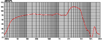

And for reference the 12LFC:
Re: Eminence Beta 15 - any good?
Looks like the Beta is a good mix between the 12LFC spec and the Delta, and from my experience it seems like it would be a nice guitar speaker with a SOLID low end without as much high end loss as the 12LFC!

The 12LFC does boost the lows even more, maybe it'd get muddier than the Beta, but the roll-off looks similar. Or did I misunderstand your first post, where you said you prefer the LFC for Bass?

I got confused haha. :facepalm: But I do agree that the curves look like the Beta would be a little less muddy
