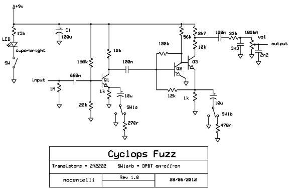

Nocentelli --- Is this yours? Fuzzface based?
Selfdestroyer---ohhhh thank you. I could play with values to taste. Maybe a Dark Meat Ritual...

Re: one knob fuzzies
yes the meathead is a colorsound one knob. the meathead uses different pinout on the transistors so this may be why some people have reported the PCB's not being the same. I am designing a PCB to allow building of every fuzz face type circuit variation so you can stock up and just be impulsive with the DIY at a later date. here is a list of what I found that is similar in circuit topology.
fuzz face
muff fuzz
colorsound one knob
meathead
FY-2 (without the tone stack)
there are two ways to have a one knob pedal. do you want one sound with a volume control on the output or a dirt control that gets louder as you turn it up?
on a nazo fuzz, I think most people use them with the gain %100 anyway. try building it without the gain pot VR1 and remove the R5 15k. if you put the clipping diodes after the volume pot on the output, you will have a one knob dirt control and volume control all in one!
I never got this strip layout working so it might actually be wrong. check it against the schematic before you build it.
Nazo fuzz. NICE.
Thank you kindly for sharing. Can you swap out those NPNs for 3904s or similar? Would it become a gainny noise mess?
