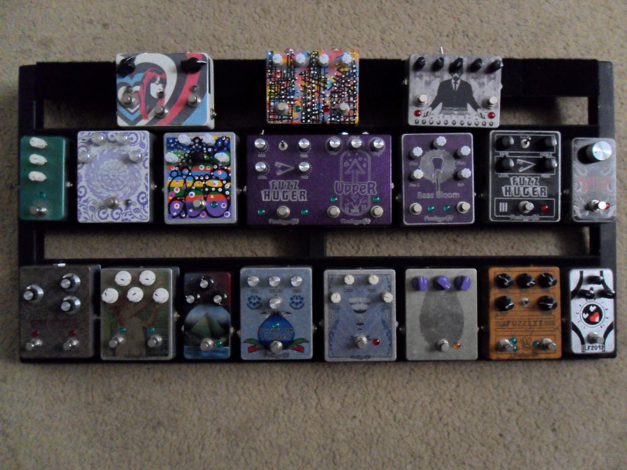

YES get a modded Algal... The Germanium option DOES lend itself to broken amp sounds when used win conjunction with the starve... I have an Algal with a 5 way selector that has regular Silicon, Blue Led, Red Led, Germanium, and double Silicon and I mainly use the Germanium cause it gets so gnarly and sputtery... Thomass does make a Bass Bloom that has a clean blend and I assume that his bass boost mod came from working on that but I have not played one, might get that on my 4th Algal when I order a XS version... The LED versions can get real loud and have more headroom and I like to use them stacked with other dirt, if the Red doesn't sound right the Blue will... If you have the ca$h, which won't be much cause Thoms a Pimp, then just go all out and get all the mods... Also ask Thom if he has any blems laying around or really splash out, like I did, and get a Laura Bennett painted one... Whichever one you get you WONT be disappointed...

It's the painted one next to the Upper Huger... :love:
