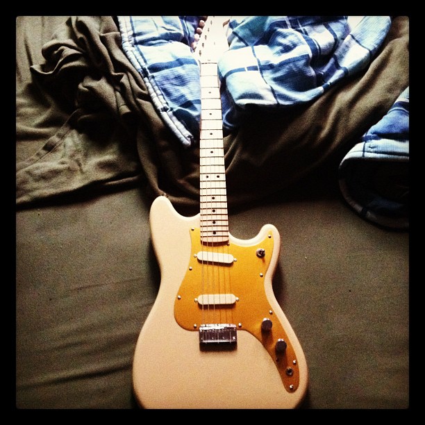

Yup, did!
First of all I really love it. It's so much fun to play, the neck is awesome and I love the overall spankiness of the sound. Just so... I can't describe it but it feels so right for a lot of things.
I ditched the tone pot because it was always on full throttle anyway, got a little more edge and nagging highs I think but that might just be because I also changed the Pickups when I did that. Got a pair of Creamery Red '79 and dropped them in. Best. Thing. To. Do. EVAR! Really it lifted the guitar to a whole other level. While I was at it I changed the switching so that the middle position made both act as a humbucker and that sounds awesome too. All of a sudden the guitar gets so warm and opens up all the fuzzes. Lovely.
Later on I exchanged the saddles for Glendale Brass saddles that did not affect the tone too much, but sustain increased a bit. She is still blunt and direct, but a nice little less so. The saddles are made for a Tele though so I think the string spacing is a bit off. They look like rotten teeth on her and I kinda like that. I couldn't get the low E to intonate properly but that might just be a case of string thickness. I think Glendale has a special saddle for when the E string goes above 48.
I still want to refinish her to a translucent or sherwood green. I'm not a fan of the beige/gold/wood look. A different nut might also be in order.
Edit for Webstagram getting back to work (old saddles still):

your guitar looks sick with those pickups.. .i was thinking about putting lipstick pickups in mine.. but i may look into getting the pickups you have as well
maybe i'll mix and match ...
Cheers man!
