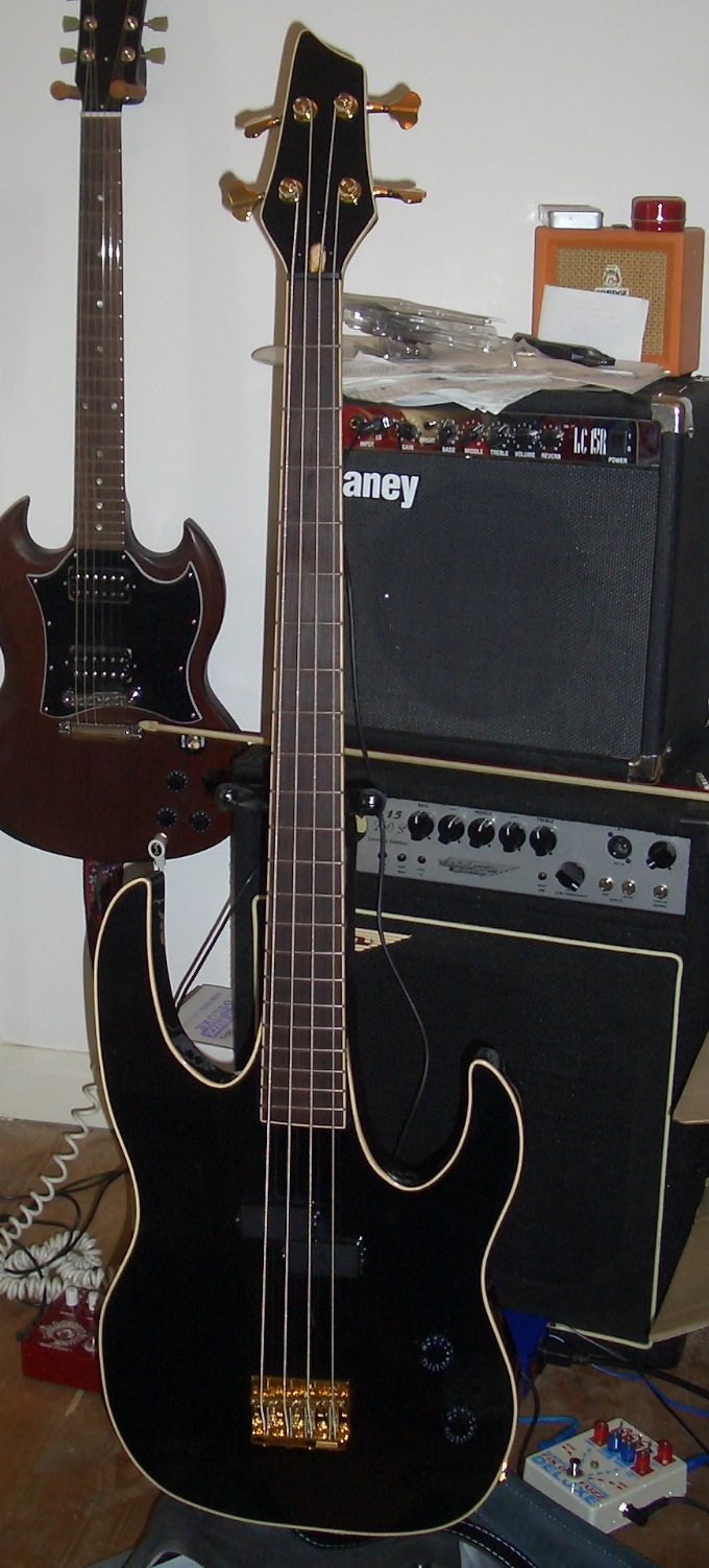

Finally finished my home-built bass after pretty exactly one year (build thread here.)
Some setup work left to do but it's playable already.
Maple set neck and Alder body, rosewood fretboard, split coil pickup. Currently tuned to C standard.

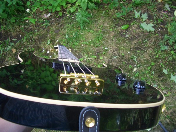

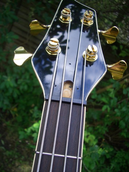

OMG pix!!!
(all clickable for larger size)

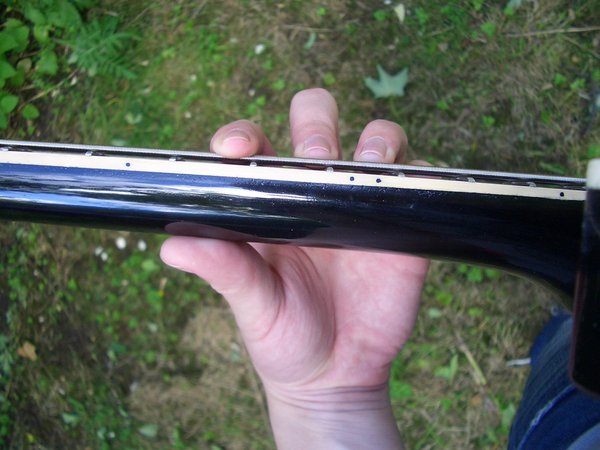

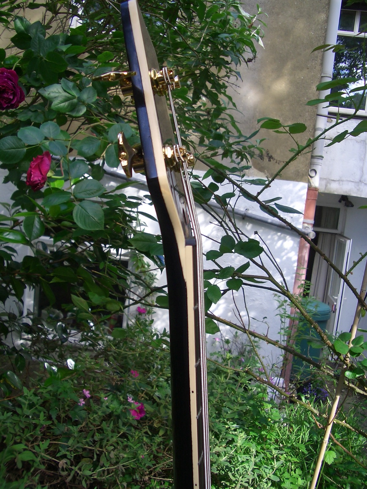

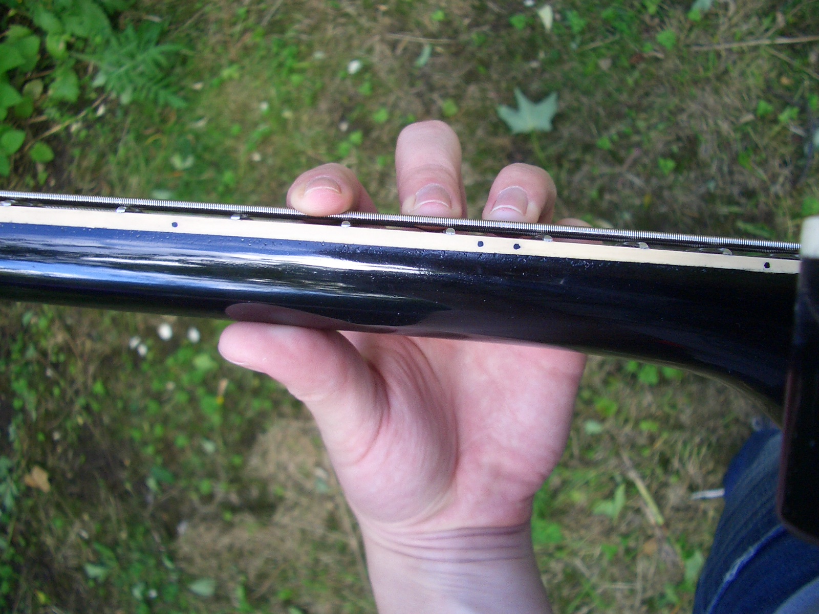

The very thick neck, may not even need the trussrod. I'm tempted to get the file out again and thin it down - maybe in a few months time?

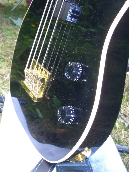

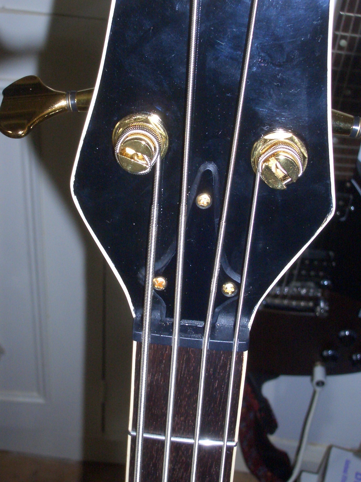

I do like how the picture below turned out.
Since then I've installed the trussrod cover.

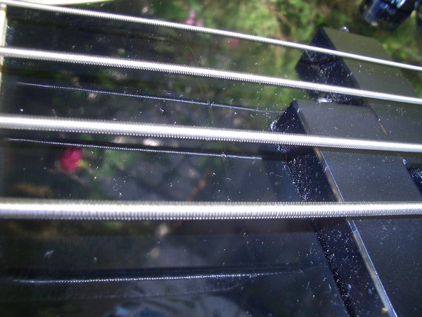

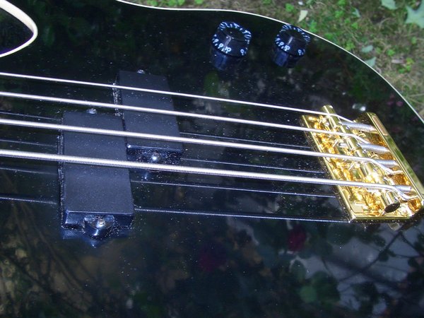

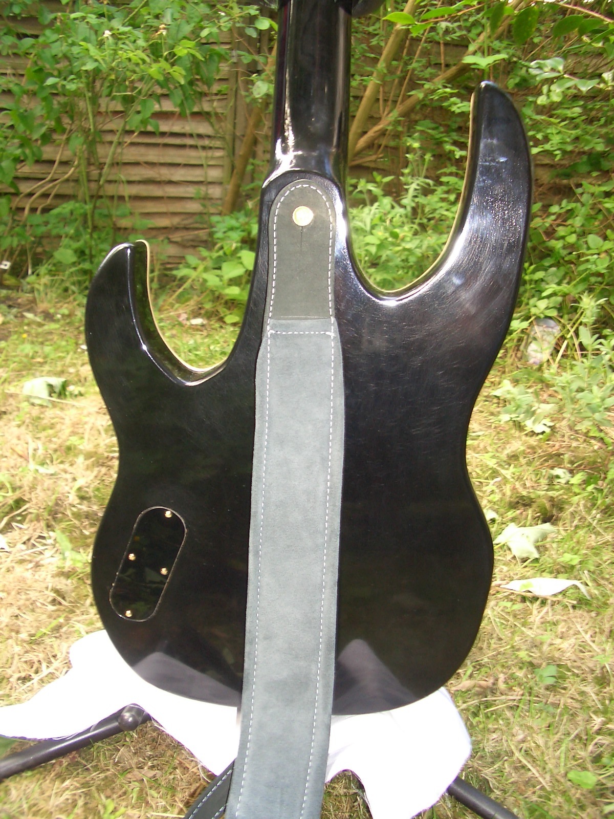

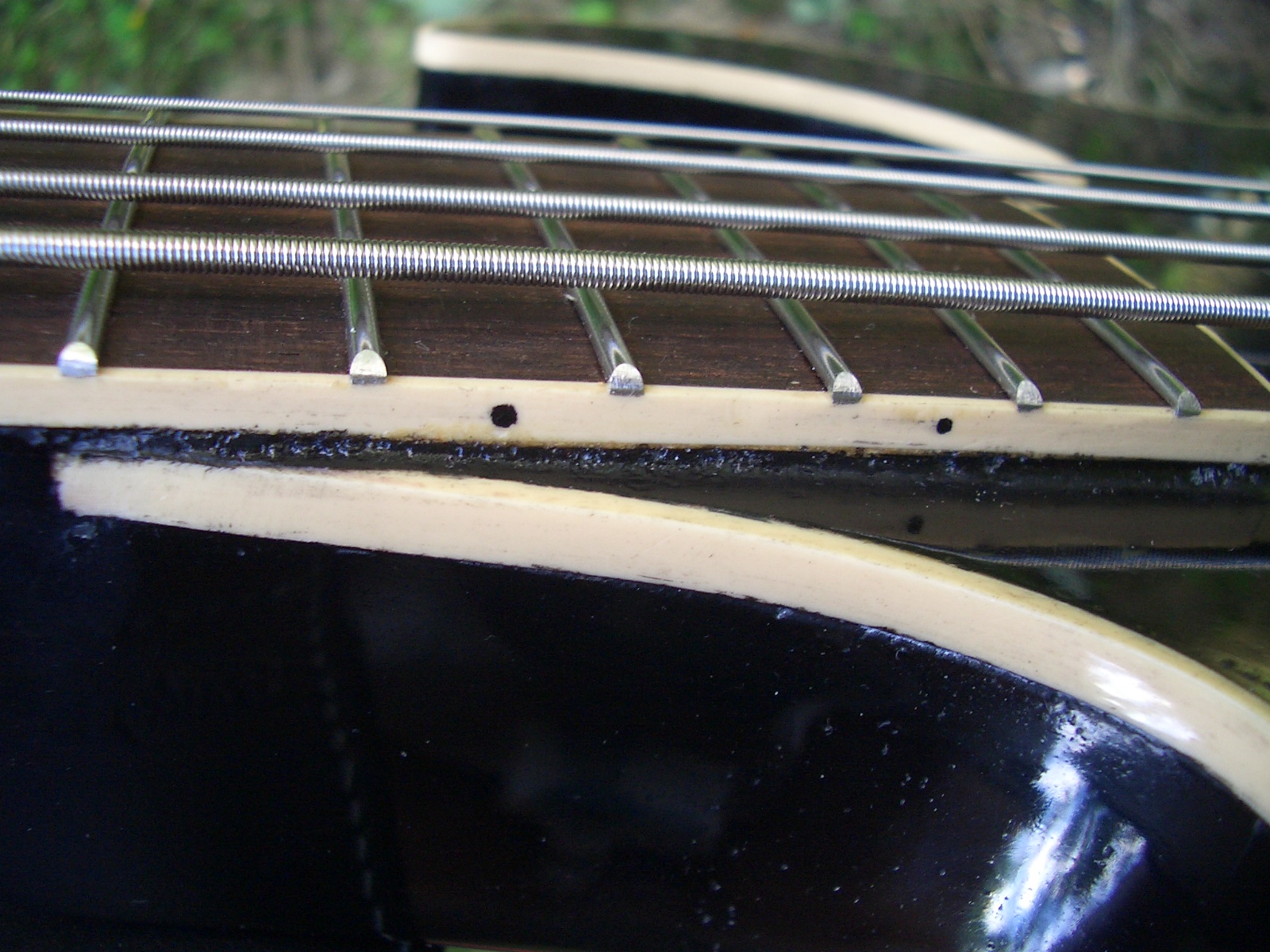

And now for the not so glamorous shots.
As I mentioned in the build thread, the cross grain cuts proved a problem for the lacquer with lots of pin sized holes appearing. Also note the slight bleed onto the binding.

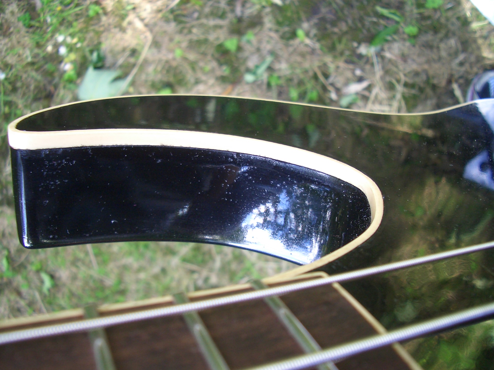

If you look closely you can see the edge of the neck heel extending into the body here:

I like thick necks. I'd say keep it the way it is unless it's too uncomfortable for you.
Posts: 13949
Re: NBD - one year in the making
I LIKE THICK NECKS AND I CANNOT LIE

Re: the thick neck: I did want a thicker neck to take some pressure off the thumb but it takes some getting used to. It feels very strange switching between this and my Jet King with the typically skinny Ibanez neck.
