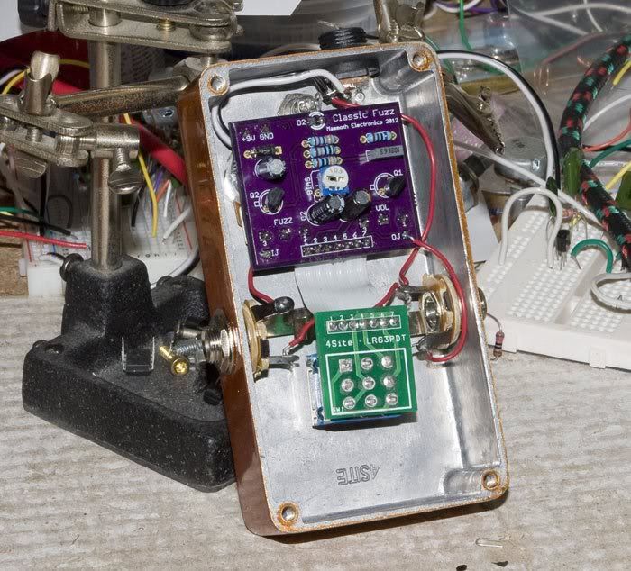

To put a very fine point on it: the circuit is a modern replica of the tried-and-true Fuzz Face circuit, with a few minor changes. Those changes best being summed up as an added bias trimmer and also a RF filter cap added at the input (to help filter out AM radio station reception that sometimes plagues fuzz builds). These were not present in the original, but are great add-ons that you'll see in most any DIY kit or boutique build these days.
The kit is spec'd for silicon transistors, which are far more forgiving than germanium. It is negative-ground, which means it will play nice with your pedal board power supply.
The real benefits for the pedal builder newcomer, however, are all in the details of construction. As Blake mentioned, as much of the off-board wiring as possible as been consolidated into the 7-pin ribbon cable. No wiring up the LED off-board, and the stomp switch wiring is all handled with the little switch-mount PCB. Should be a relatively easy build and a simple wiring diagram.
Anyway, there is still a small bit of tweaking to do, but we're 95% of the way there. I built a test unit to see if everything fit, and most things worked out just as expected.
Here's the inside of that test build. What I forgot was extra ground pads for the input/output jacks. So the production kits will be neater and easier.
The final kits will ship with cool metal-can transistors for extra mojo. :thumb:
