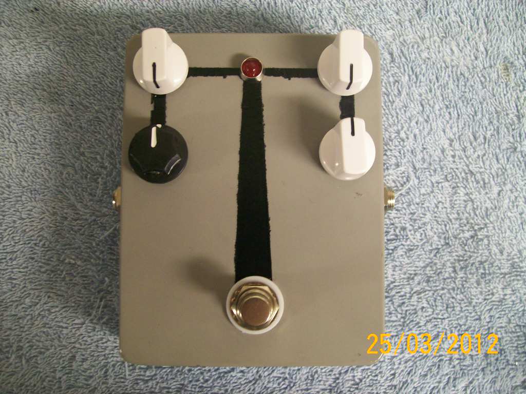

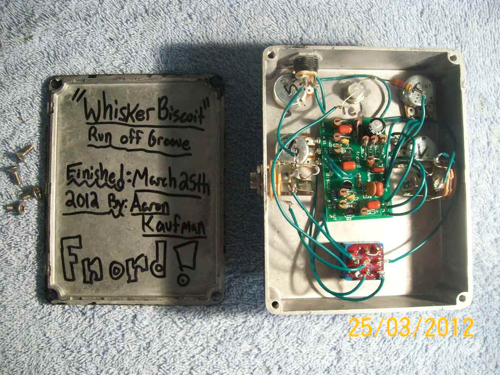

I posted this in the Let us see your DIY projects thread, but here it is anyway. Mine is kinda quiet compared to other pedals that I have, is there a way to fix that?

The4455 wrote:I posted this in the Let us see your DIY projects thread, but here it is anyway. Mine is kinda quiet compared to other pedals that I have, is there a way to fix that?
Quiet as in lacking output volume? Mine is WAY loud. I run the volume down around 11 o'clock or so.
