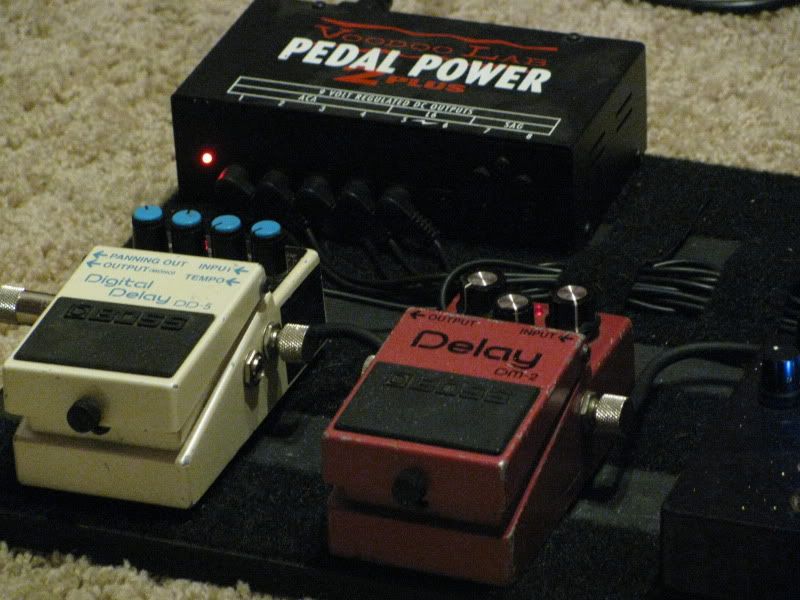

I have one and its old and looking rough. Can that pedal be rehoused? I would need to to be reversible if i ever decided to sell it.

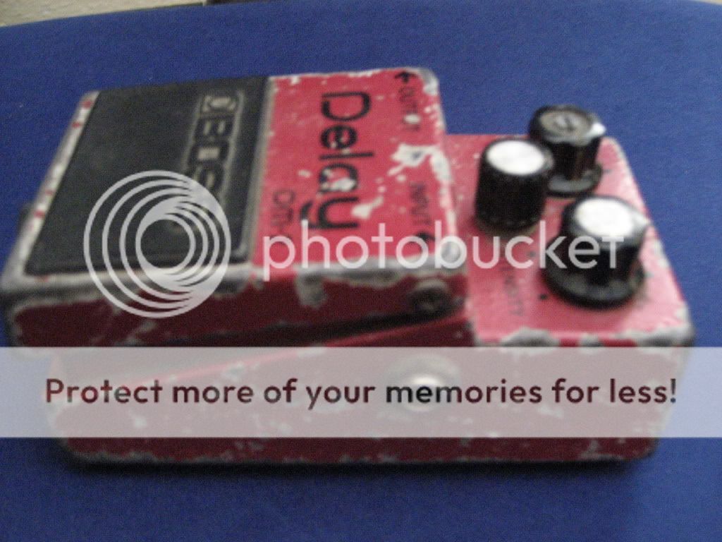

There is nothing wrong with a relic-ed dm-2. here is mine..

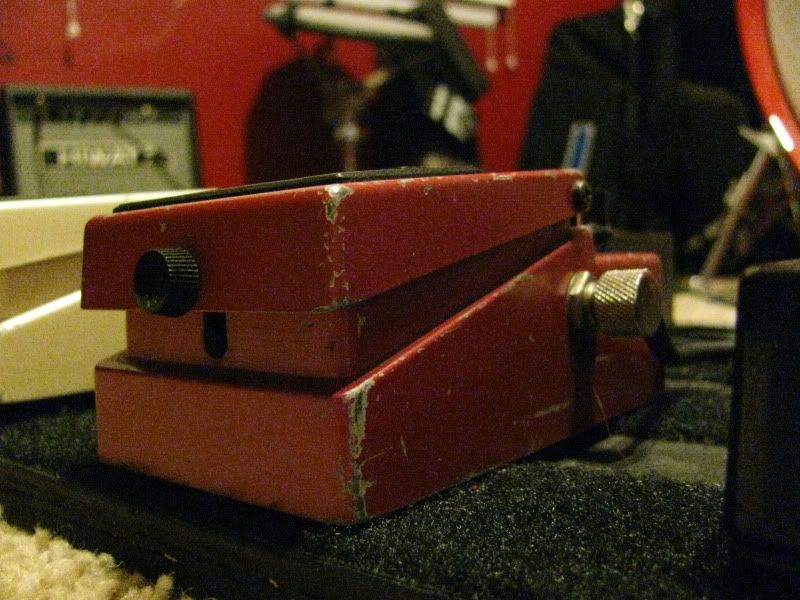

Yea mine is the DM-2B
Marking of PCB: ET-5214-510B
BBD: MN3205
Clock Driver: MN3102
mines not too bad looking. I just think it needs a tuneup. The LED barely turns on and it just feels "weak" compared to any demo ive heard of it. Id be down to hunting down someone who could do a rehouse on it here in the near future.

Did you flip the dip switch on your Pedal Power to compensate for the 12V versus 9V? Some old Boss pedals run with a different adapter (PSA or ACA, I always forget which one is which) and thus if you run the pedal at 9V, the LED looks weaker and the pedal sounds not as good. Let me know if you have questions about this...
- devnulljp
- Posts: 3989
- Joined: Fri Oct 09, 2009 11:29 pm
Re: Can you rehouse a Boss DM-2?
That's exactly what I was thinking.the_necropolitan wrote:Did you flip the dip switch on your Pedal Power to compensate for the 12V versus 9V?
DM-2 runs on 12V not 9V. Try it with a battery and see if it's any different. Or flip the switch on the PP2+.
- SpaceFlunky
- Posts: 763
- Joined: Mon Jul 19, 2010 2:11 pm
- Location: 405
yea i flipped the switch on the PP2 and it did make a difference. The delay actually stands out more.
