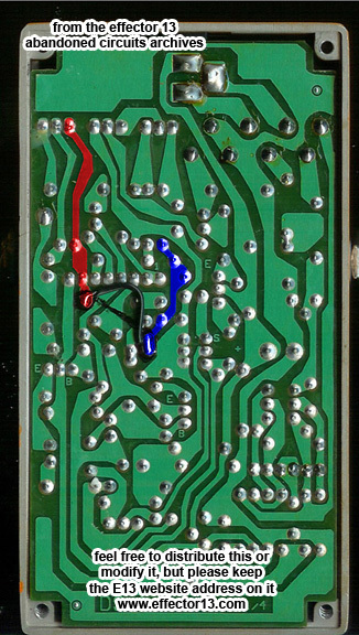

Casper Electronics has an easy and awesome mod on the site. I got the arpeggios and oscillations as well as subbass and 8-bits. One component, a switch, and wire is all ya need.

Bellyheart wrote:Casper Electronics has an easy and awesome mod on the site. I got the arpeggios and oscillations as well as subbass and 8-bits. One component, a switch, and wire is all ya need.
Is that the one where you add in a transistor?

Yep...and somehow, I think due to terrible soldering and what not, mine would do that tremolo thing as well...but it would decide when it did it.
