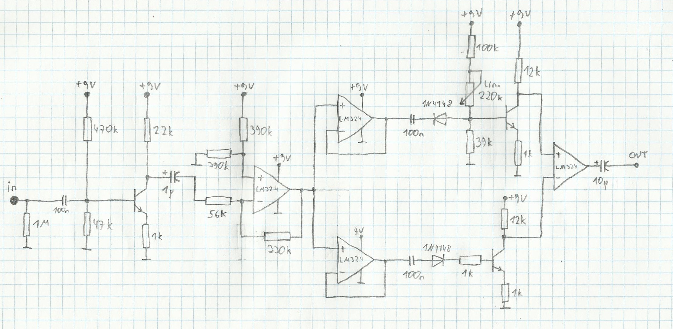

Hi.
I just sketched out a schematic for some kind of fuzz pedal, but I don't know if it's any good... Please let me know what to change, or if my idea is total crap in general.
Greetings!
Schematic
Schematic

Does the last op amp need a reference to virtual ground? I think it might, but I'm not sure

I think you maybe on to something. What is your intent for that last stage? Do you want it to work as a comparator or a mixer?

@culturejam:
I don't think so- I mean I forgot do draw the +9V supply and the GND- and I forgot the Volume Pot. at the "out"-connector... I just don't have any software to simulate it right now because I'm on vacation...
I think it could work.. but as I said- I have no possibility to test it right now..
@FullCustom:
I want it to work as sort of a comparator... but I don't know if that's possible the way I imagine it ;D

You might end up with a cool crossover notch generator. Or the start of one. If you could make it clip either side of the waveform or do crossover notch that would be really cool. I was thinking of making a pedal to do that but it looks like your going to beat me to it. If you don't have it get the Douglas Self book on small signal.

What do you mean exactly? Any ideas of how the crossover notch or the clipping for each side would look like? Suggestions are very much appreciated! And what do you mean by beating you? It's not some sort of competition here.. if you want to-you can take the schematic and use/modify it to your needs... I mean as long as you let me know how I could improve it :D
Maybe we could work something out?
