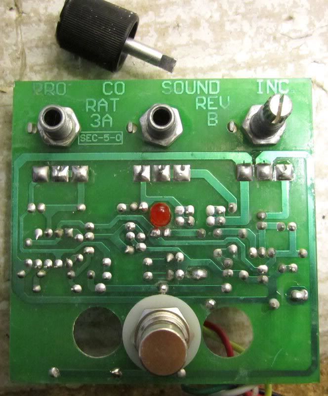

I scored a Rat 2 (a newer one made in China) in a recent cash/trade deal. I'd never owned a real Rat before the other day. The sound of this one is *okay* (sorta like a DS-1), but not as amazing as I know a Rat can sound. So of course I popped the hood and had a look inside. HORROR!!!
I also noticed that someone had clipped one end of the 47R resistor off the non-inverting input (aka, the lazy man's Reutz mod).
So I decided that I would replace all of the resistors and film/ceramic caps. Then I started to pull everything out of the case and I figured out why Keeley doesn't want to mod these. The knobs are, I believe, glued on to the shafts. I pulled two of the pot shafts completely free of the pots trying to get the knobs off. The third knob came off with some effort. So I replaced the pots as well. But of course I don't have the ones they used, so I had to jimmy up a solution that would work. It barely fits, and there is a light bit of stress on the PCB as a result, but it's not much and the board is very strong.
Busted pots:
Shot of PCB with new components (pots are now *under* the PCB instead of through):

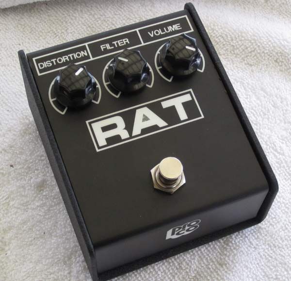

And here's the finished pedal with obviously non-stock knobs (and I love the LED through the "A"):

I've got a You Dirty Rat (totally stock) also, and it just doesn't have the balls of the reworked Rat2. Despite the difference in clipping diodes, I really think the main thing comes down to the op amp. The OP07 they are using just doesn't cut it.
