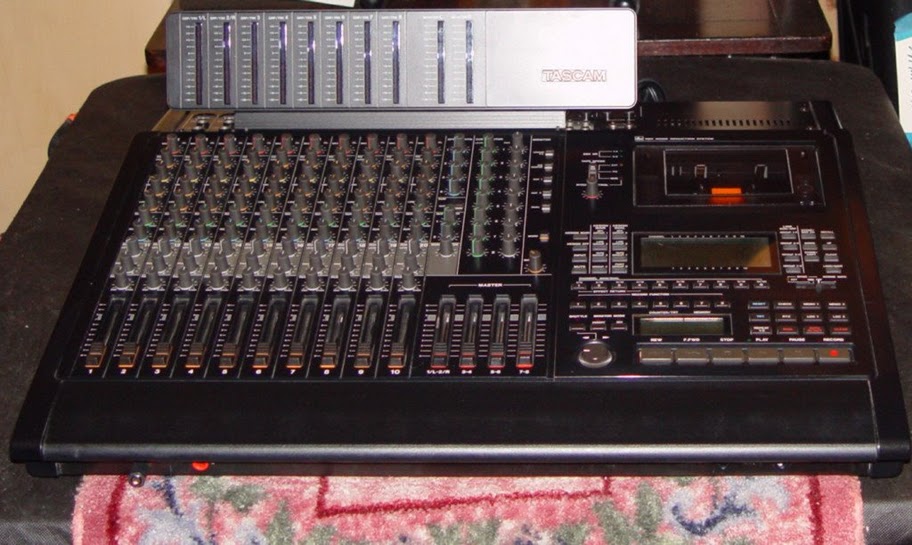

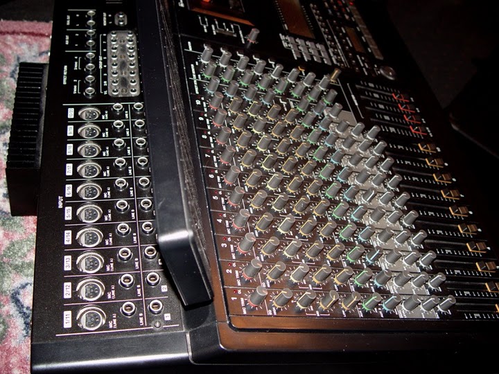

Mics only I want the sound of my amp.
Mics to Tascam 688, 688 to a/d converter to laptop.

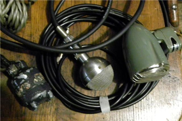

I double mic with a Sennheiser e 902 and an e 914
And have used CAD TSM-411 and TSM-412 with great results.
Great mics on a budget.
for old school retro.
