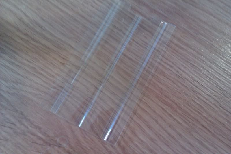

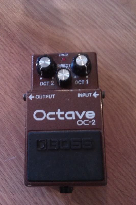

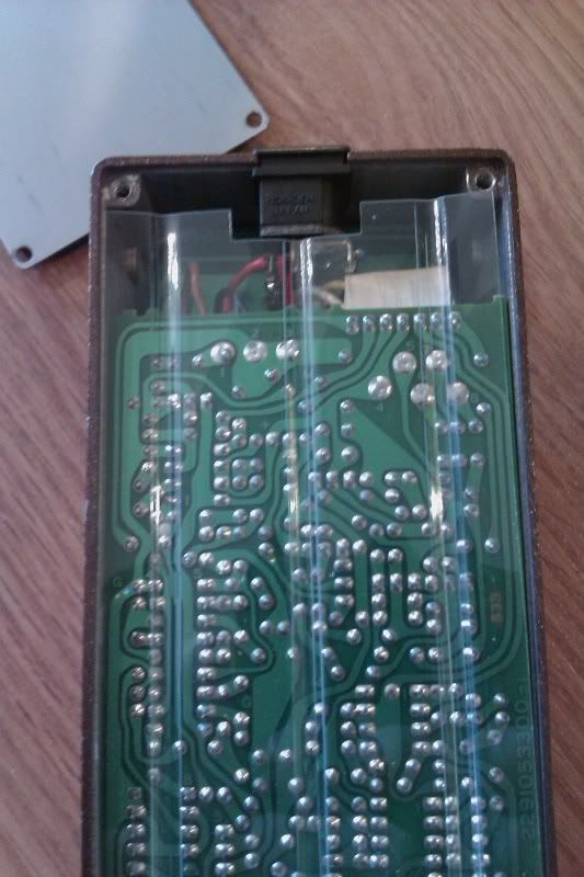

So I recently got this pedal off of Craigslist and just noticed the other day that it is making a kind of a feedback almost humming noise when engaged. It's driving me fucking nuts and I have no idea why it's going on. I opened the back up (I don't know why, because I really don't know what I'm looking for) and noticed a piece of plastic back there. Kind of odd. So I removed the plastic piece and tried it out. Without the piece it seems to work kind of spotty when the back is on. I really wish I had a way of recording clips but I don't, so maybe some pics will help?

jwar wrote:noticed a piece of plastic back there. Kind of odd. So I removed the plastic piece and tried it out. Without the piece it seems to work kind of spotty when the back is on.
Put the plastic back in there -- it's shorting out on the case otherwise, which is why you're having problems without it. All my old Boss pedals have had one of those in there.
I actually took it out for like 2 minutes and put it back in. It still makes a weird noise after playing a note. No feedback when not playing, only after I play. It's almost a thumping noise. God I wish I was better at describing thing.
How's it powered? IIRC at least some OC-2s were ACA, so need 12VDC unless sharing ground with other PSA pedals. Can you run it with a battery, with nothing else in the chain and see if that changes things? Is there a sticker on the power supply jack that says ACA or PSA?
You want to put that plastic sheet back in because it insulates the solder side of the board from grounding out all the connections to the bottom plate. Definitely try it on it's own with a brand new battery to see if it's misbehaving under low voltage from either the wrong kind of adapter or a daisy chain. Also try it out with nothing else in the chain... guitar --> OC-2 --> amp. However unlikely, perhaps you have a pedal that just does not get along well with the OC-2. Does it pass dry signal in bypass, or does it always misbehave? Does the "wrong" kind of sound come out all the time or only when you are playing the guitar?

devnulljp wrote:How's it powered? IIRC at least some OC-2s were ACA, so need 12VDC unless sharing ground with other PSA pedals. Can you run it with a battery, with nothing else in the chain and see if that changes things? Is there a sticker on the power supply jack that says ACA or PSA?
Ok! I just looked on the back of the pedal and it says ACA but the adapter is PSA. So perhaps that's the issue, although I did just try it with a battery and it's still acting weird.

Can you daisy chain it with another PSA pedal? That way you'll have a common ground so you'll bypass the the diode resistor circuit that regulates the 12VDC down to 9.something V.
