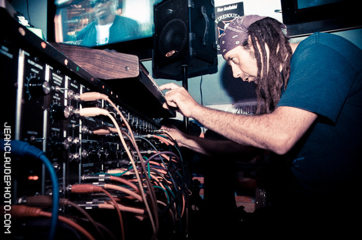

I really like my synthesizers.com modular synth. It is based on the Moog modulars from the 70's. The set up really helped me understand my other synts (Arp Axxe and Korg MS 2000).
You can sign up for a monthly plan $120.00 per month for 12 months. At the end of 12 months you have this.http://www.synthesizers.com/system-entry1.html. I have been gigging with this and it sounds great. The Synthesizers.com units are pretty large but I like the large knobs. The Doepfer units are a lot smaller and easier to transport. http://www.blacet.com/ make some nice units also . The cool thing is that all of these company's are interchangable. Synthesizers.com have a lot of info on there web site. compatability charts and other links. If you like making NOIZE this is the best noize box out there and running it thru effects...well you will never leave your house again!!! Hope this was somewhat helpful.
