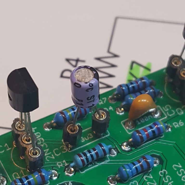

You got the right idea with the sag control. It is called starve on other pedals. More starve is more resistance is more cw is less power. I may update the build doc to say that you can use electrolytic now that people have had good results. The PCB has no mark to indicate polarity so it may cause more problems than it is worth just to save money on parts. I have to sell all the PCB before I can make an updated version. For now people can get the polarity from the discussion here someone already figured it out.
- BetterOffShred
- Posts: 3412
Re: WOLF COMPUTER DIY DID YOU BUILD IT?
This pic shows the orientation before I trimmed the leads on everything.

I realized in my little build report I said positive pole towards the 100n and it's opposite in the picture. I meant towards it in the schematic.. which on the board is negative pole towards the 100n monolithic there.
