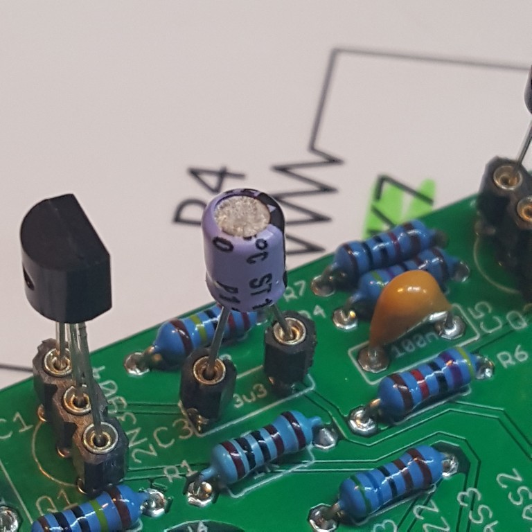

Built it. Works. Had to hook up tone 1 to volume 3 (maybe the other way around don't have the schematic in front of me) sounds great. I really like the mods. I used a 3u3 polarized with the positive pole towards the 100n and that works fine. I don't have a b25k or any 25k for that matter so I had to use an A50k for fuzz.. that's definitely sub-optimal. And then I may use smaller values for the sag controls, but the fine is really nice imo.

I played around with it a little more and I think I'll keep the 10k and 1k sag values. It's useful the whole sweep, and does some nutty Random Number Generator stuff with the sag all the way up. It's also highly interactive with the bias control of course so that leads to interesting sounds. I think I'm going to swap the lugs on the sag controls so as you "turn them up" you're actually starving more voltage, viewing the sag knob as something you engage rather than voltage something you turn up.. if that makes sense. Not sure. Maybe I'll just call it "Voltage" and leave it as is haha. Doesn't really matter.

You got the right idea with the sag control. It is called starve on other pedals. More starve is more resistance is more cw is less power. I may update the build doc to say that you can use electrolytic now that people have had good results. The PCB has no mark to indicate polarity so it may cause more problems than it is worth just to save money on parts. I have to sell all the PCB before I can make an updated version. For now people can get the polarity from the discussion here someone already figured it out.

This pic shows the orientation before I trimmed the leads on everything.

I realized in my little build report I said positive pole towards the 100n and it's opposite in the picture. I meant towards it in the schematic.. which on the board is negative pole towards the 100n monolithic there. ;)
